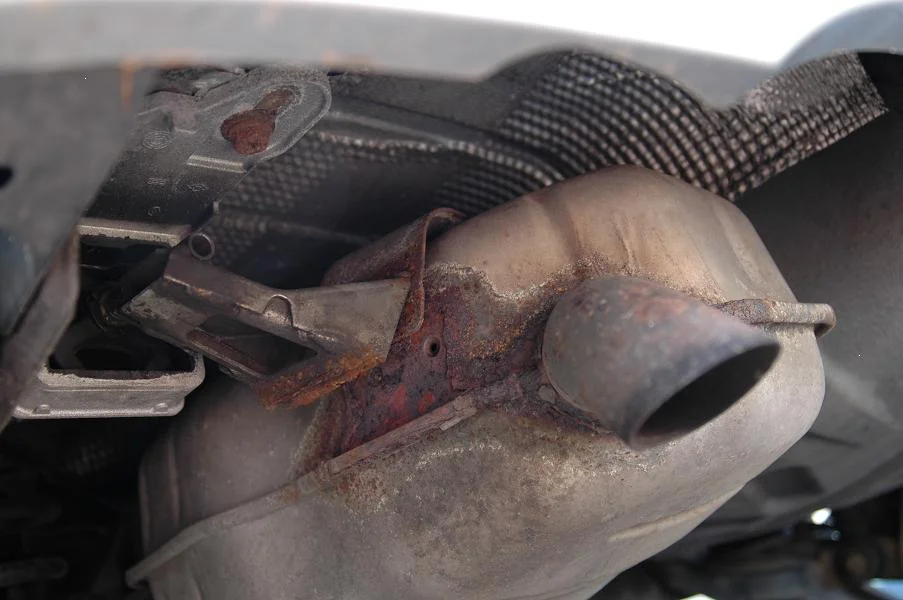

Is this broken, will I need a new one?
It is also very raspy at certain speeds and the renault stealer said it was something in the middle that has collapsed?
How much is a stealth compared to having a standard one refitted?

Mate, I had exactly the same happening to me a week ago. I went to a small local garage that managed to weld it back up (but he wasn't 100% sure he could do it before trying). Mucho cheaper than changing the damn thing. Also he advised me to attach the exhaust with some metal wire to the car as to not put too much strain on the line (there are a couple of holes in which you can pass the wire. (the car went in about a week after I first asked him)

lol thats fucked. IMO i wouldnt replace it with a renault one. a stelth can be had for 3ton,. ul pay that if not more for a full systems which will fail again soon
Slightly bemused as I was just quoted £800 from renault for a complete new system!!! That cant be right!!! I was almost speechless!! Thats with a cat.
If I go with a K-tec stealth will the car pass the in 12 months? or will the emissions be too high?!

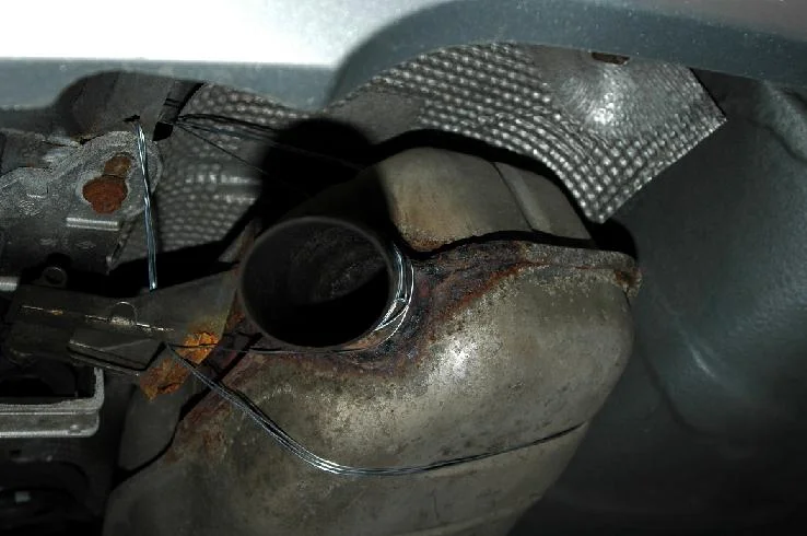

Held it up with light weight garden/chicken wire type stuff, seems quite solid. Wrapped it round a few times, and hooked it through part of the body work, will put piccy on when camera battery charged, gonna get a k-tec steath if they are road legal that is and they will pass MOT... any body know if this is the case?
