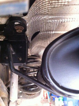

My exhaust rubbers in the clamp on the back has snapped yet again. They only seem to last 6 months ish. Just wondered if this was a bit of a common fault for Renault as its pretty rubbish really. Fed up with them snapping all the time. The guy at the garage said that the back box is quite heavy for the car and that puts a lot of pressure on the exhaust mount. I have a standard exhaust aswell. Anything else I can do because its annoying !

Very common covered on here a lot.
Get some cable ties to hold the mount up inside the rubber parts, can also use hose and old sockets

They are absolute pants. The socket bodge looks pretty sturdy tho (I think there's a pic on Emma's 'Officially a sheep' thread).
I just bought a new mount from ECP and it does feel quite stern, a lot better than the one's I've bought before from local Motor factors which lasted about 1 month!

Ive found the springs from a 106 gti/VTS exhaust manifold to cat work well when cable tied in. Cut them down a bit first though and they give a bit that bit of compression/flex you need

ideal thanks for all the help ! Will try some out ! I had a twin exhaust like you Emma got rid of it and it still broke on the mount !
