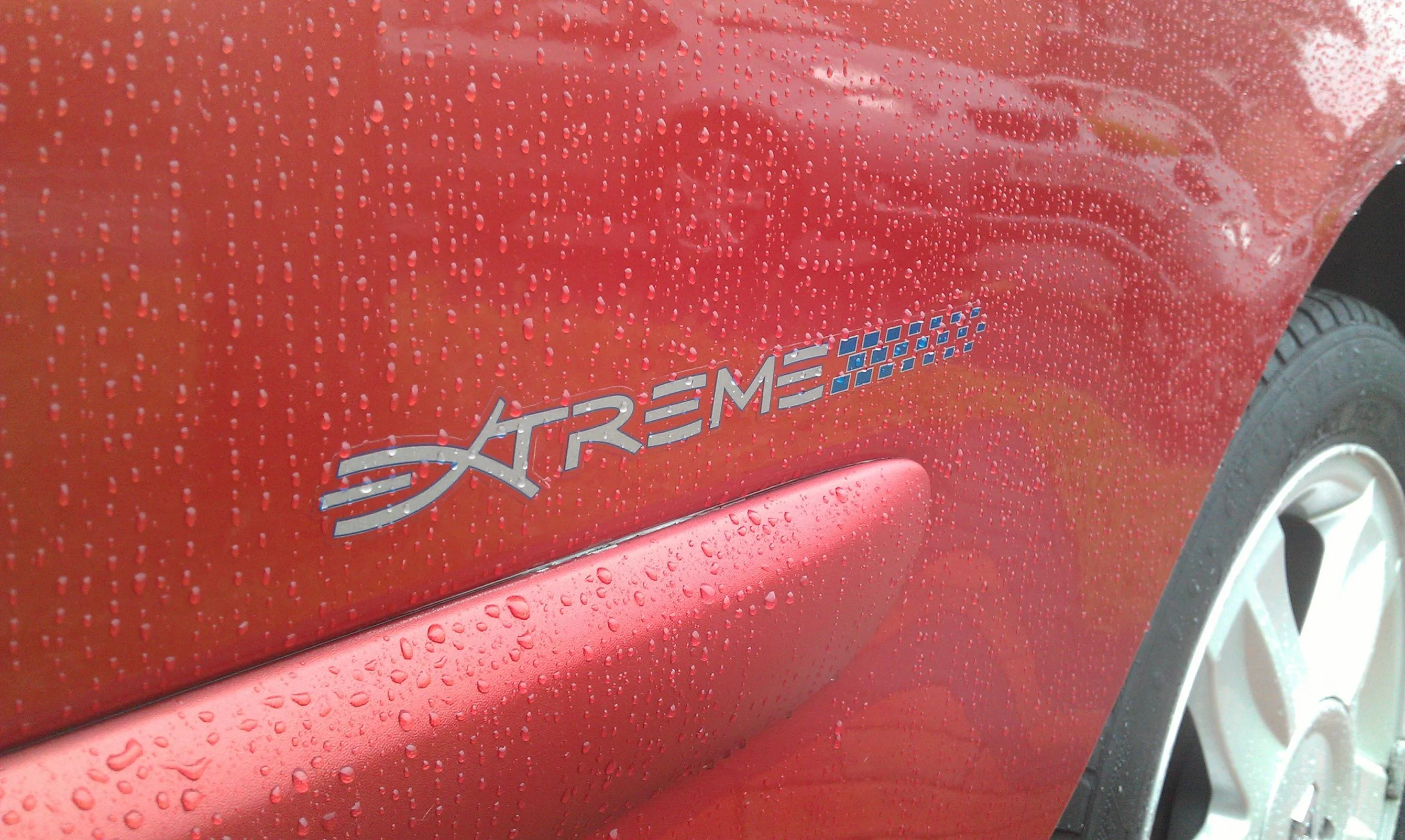

Does anyone know if you could just peel the Extreme sticker off of the side of the car? and if not how would i go about removing it?
Thanks in advance
Yes you can, hairdryer to apply moderate heat, not HOT and peel away and a bit of tar remover to tidy up residue.
