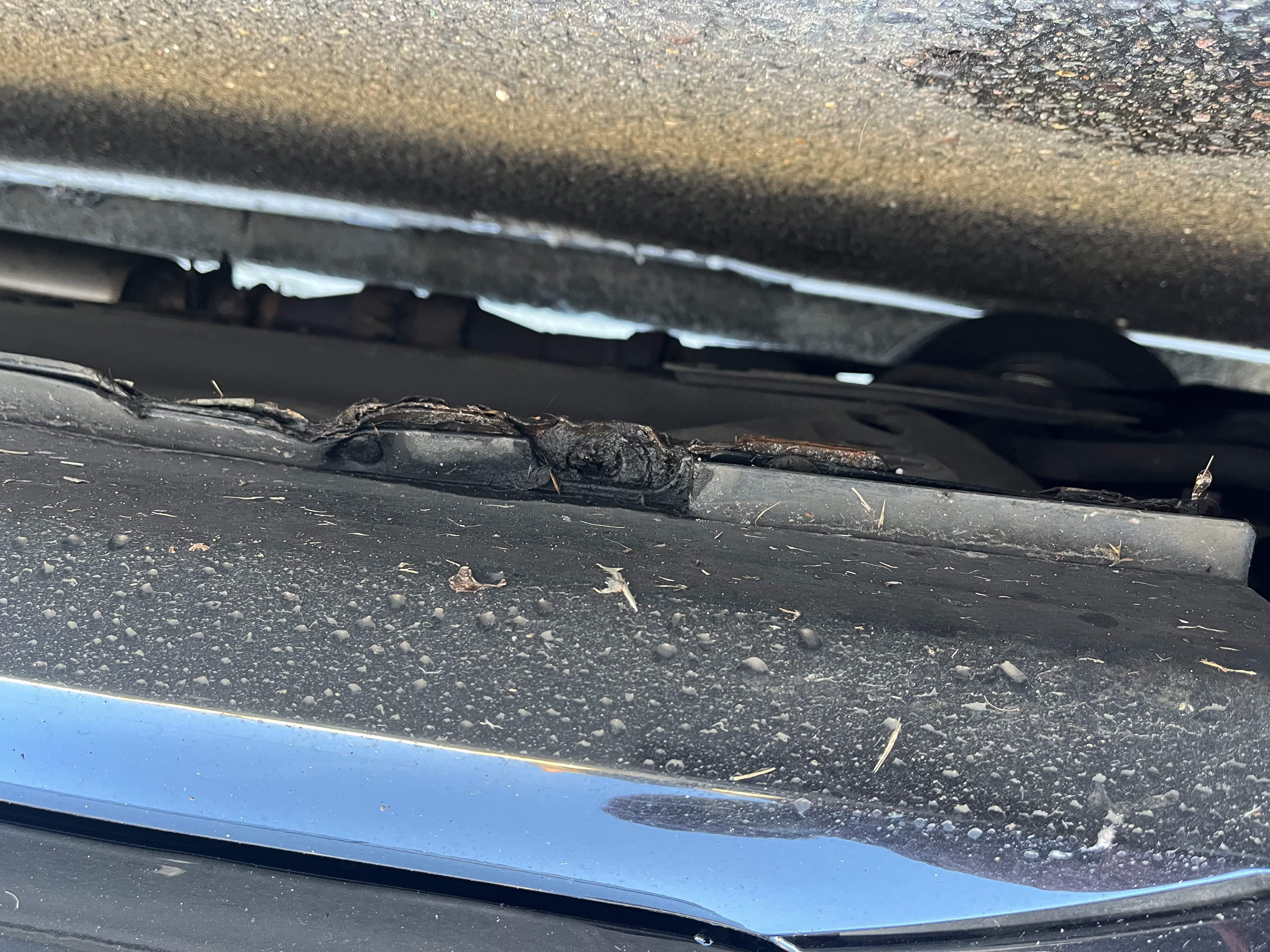

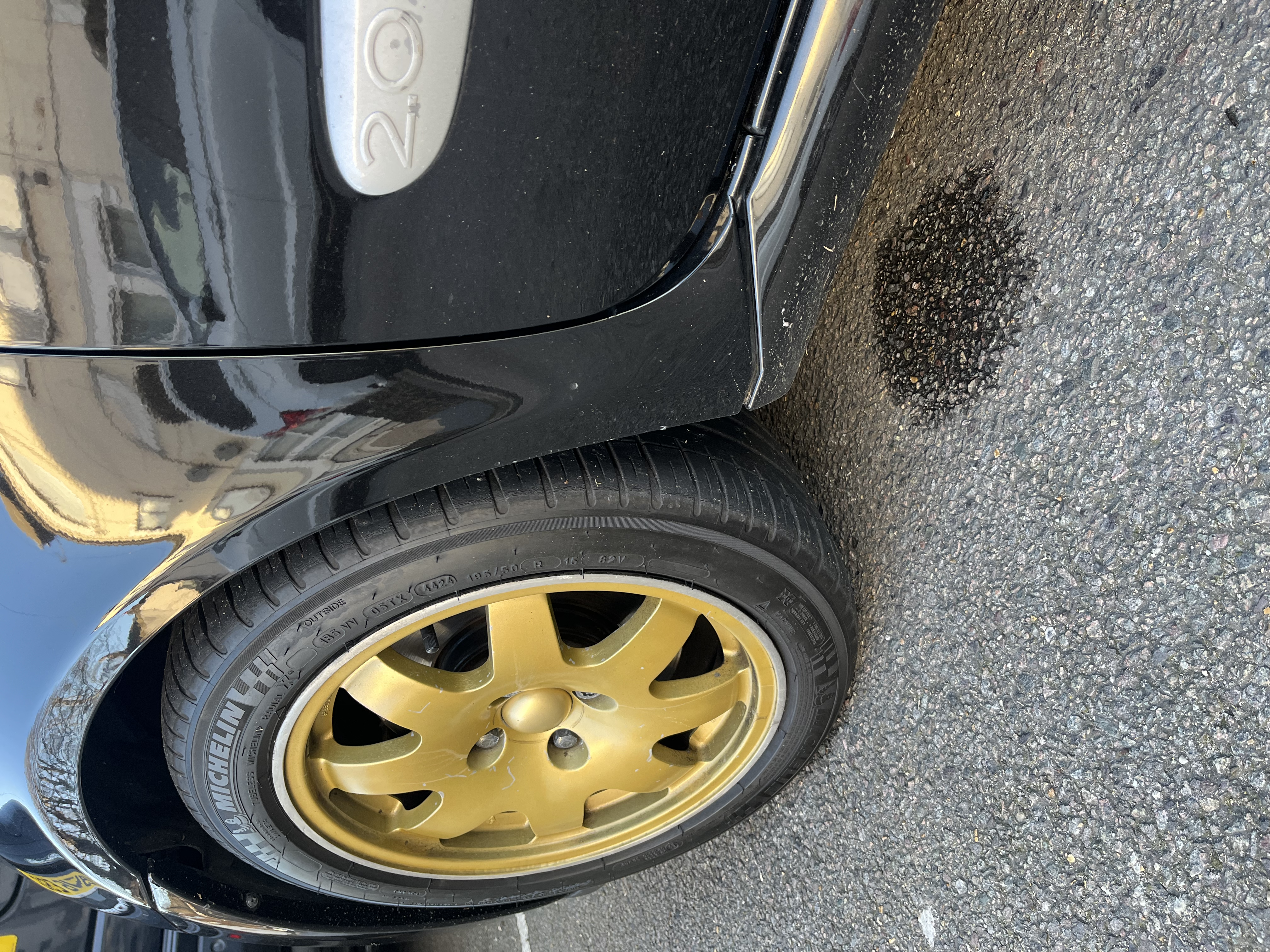

Does anyone know why my 182 is always pissing from side skirt? (front, see photo).
Seems to be holding water somewhere but can't for the life of me figure out where the drain is for clearing.
Have done a bit of research and found this could be from sills which has 3 drains on it. Mine are slightly crushed so have no idea what there meant to look like or what I'm looking for - if anyone has photos of all 3 that would be amazing,
Couple of questions
Are front sill drains located by the front "jacking point"?
Can dirt behind arch lining have anything to do with this? due to whip these of for a clean.
Any suggestions more than welcome
Thanks in advance

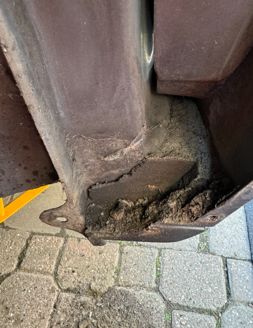

As the guys (@Martin_172 & @Mr Trailer Man) above mention - I'll guarantee that you'll have packed dirt/mud behind the arch liner. Here's what was behind mine when I took them off in August '24.
Be careful not to damage the arch liners taking them out also - they are like hen's teeth to replace - or silly expensive for what they are when they come up for sale. Thankfully, they are fairly robust and can flex a lot.
Definitely worth investing some replacement clips and fastenings before you do it also. They are cheap to replace and much easier to put everything back with new fittings.
