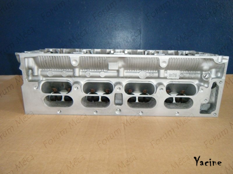

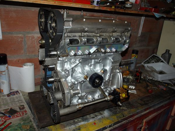

The problem with the BTCC engines is that yes they do make 300-320bhp but internally they're completely different to the normal F7R's and they only have a running lifespan of about 4 hours.
This is what the head on them looks like
The Clio & Megane Maxi cars were 270-180bhp depending on altitude
