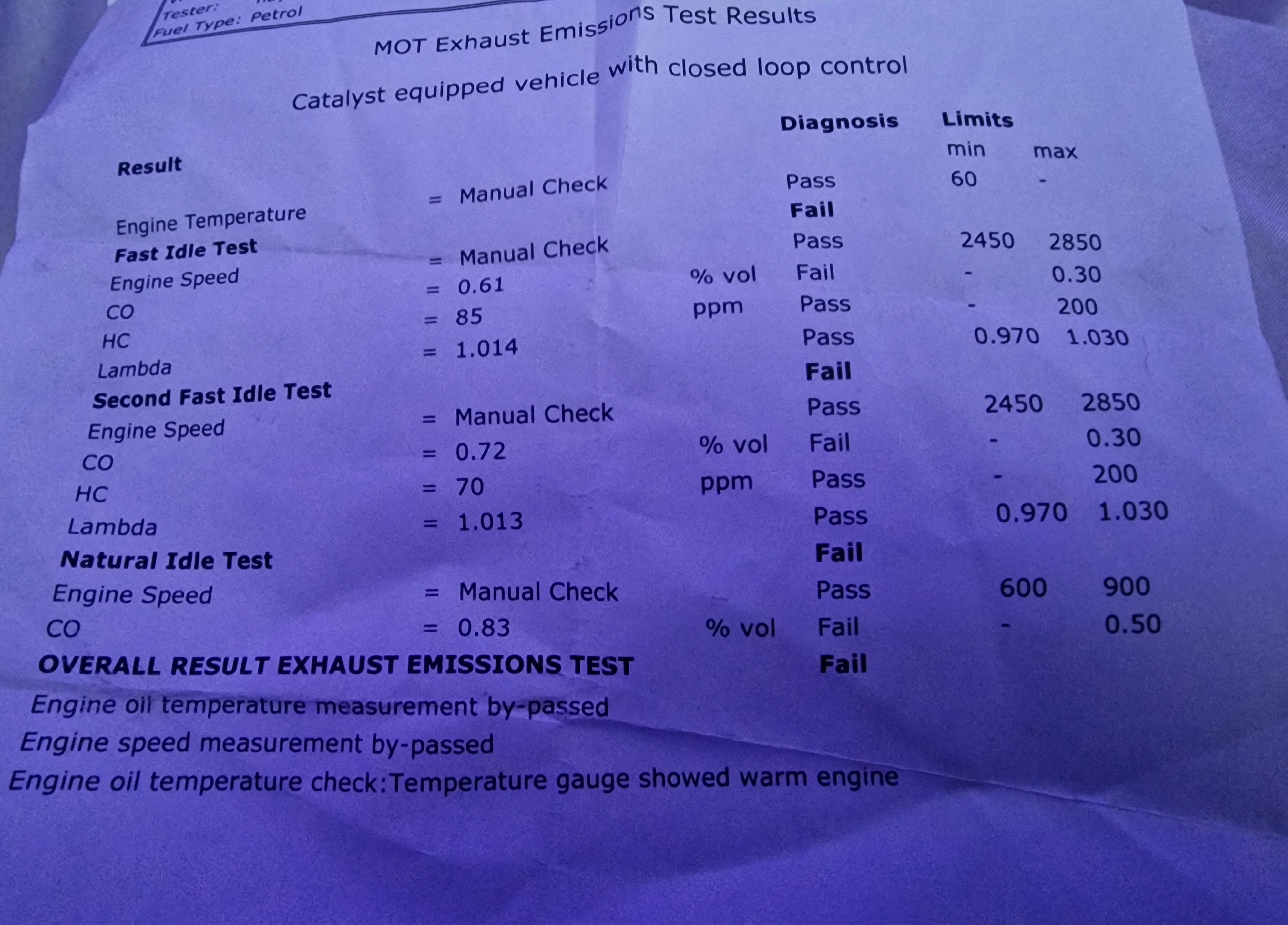

Mot yesterday and unfortunately it's failed on emissions. Garage was not very helpful in pointing me in any direction to the cause.
Before mot I replaced.
Oil and filter
Spark plugs and ignition coils
Both o2 sensors
Map sensor and coolant sensor
Car seems to run fine no eml light or any codes
Here is a printout of the results attached
Hopefully someone on here understands all these numbers.

Get it f**king hot before the test, the cats are notorious for only scraping a pass.
See if the garage will let you book a time for the emissions retest, tell them the cat needs to be stinking hot so you want to bring it in and put it straight on the machine.
