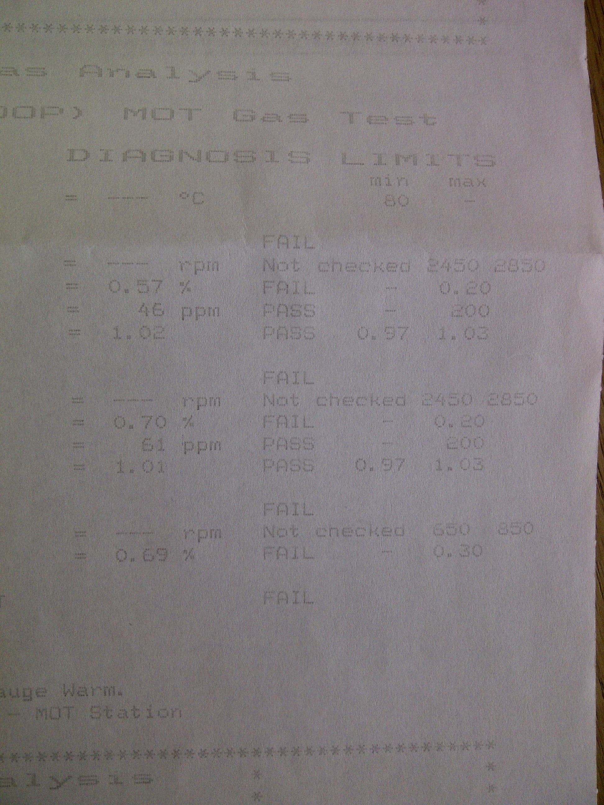

My Clio failed MOT today on emissions (amongst a few other small bits).
Spec is:
2004 172 Cup 105K miles
Standard Exhuast (although non OEM replacement)
Standard CAT
Recently replaced 2 x Lambda
Cup racer style Induction kit with Ph1 airbox (relocated battery to boot)
Results are below (failed on CO level):
What would be the best course of action to bring it within the MOT requirements. I have added a bottle of Petrol system cleaner to the tank already.

Stupid question but what causes a high CO reading?

As far a I knoweth cat is original. Don't think it's that though as it passed everything but CO
  Clio 172
The hydrocarbons are getting higher between fast idle 1 and 2 which is normally indication of unburnt fuel and would say very normal if a touch high but not to worry about. And the Co goes sky high which is normally the indication of a knackered cat or worst case burnt oil in the emissions, for example rings or valves stems but you'd see this for that to happen.
My bet is it needs a cat, I'm sure you don't have worn engine internals and if the engine was running incorrectly such qs poor timing, missfire etc there would be an eml. Though if you opt for a pattern/aftermarket/race cat it will need to get very got hot to get within the limit of 0.20 and don't tend to last around 10 years which a genuine oem cat does.

Just for a general reference.
CO fail normally means cat aging or failed/burning oil/other engine issue
HC fail normally means unburnt fuel which can lead to premature cat failure and is normally pickup via the ecu unless it's been mapped
Lambda fail normally indicates an exhaust leak or other engine issue
Those are just a general reference and the first things I would test or consider depending on what emissions wise it failed.

Managed to get it booked in for re-test this morning! All passed and good to go.
Hate to think how much it would have cost if I wasn't able to do the work myself (the parts needed came to £300 alone (needed a new rear calliper and a few other bits also!).
