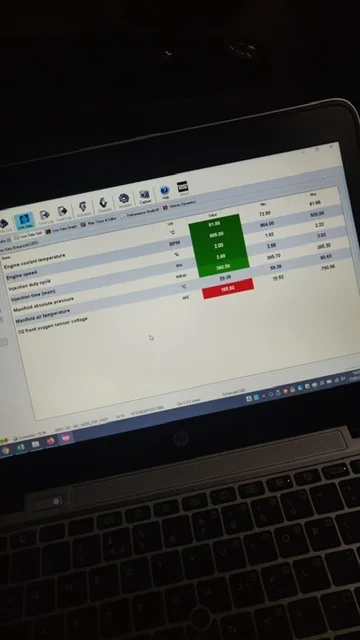

MOT today and the car failed on both CO and HC, lambda reading was the only one that passed.
I’ve had it fail about 5 years ago on this but the results then were much higher and the diagnostics pulled a pending fault with the RsTuner for the lambda which was subsequently replaced.

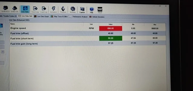

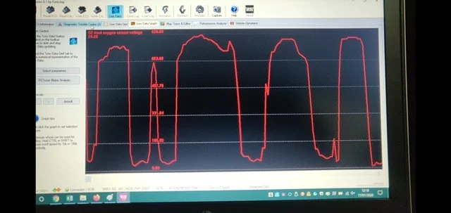

However this time there are no errors and the diagnostic readings all look fairly normal. The front O2 is fluctuating voltage etc.
Has anyone had an MOT result with similar figures and found what was needed to fix it?

As said on your thread earlier dude. Mine did similar this year, also showing no faults, unusual behaviour or excess fuel consumption.
Turned out to be the pre cat lambda.
frayz
It was still doing 36mpg with the CO through the roof!
Naturally I was really shocked it failed the emissions as there was no signs of an issue otherwise.
