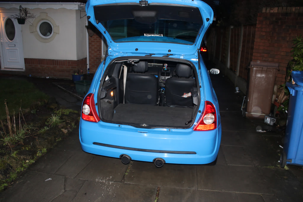

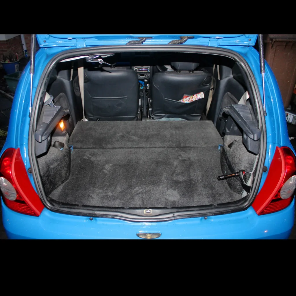

Stripped the 182 out finally and i wasn't really a fan of the bare metal look so i decided to make a false floor to try and neaten it up a little. Took it for a clean and got a couple of photos, I'm still 50/50 on weather i like it.

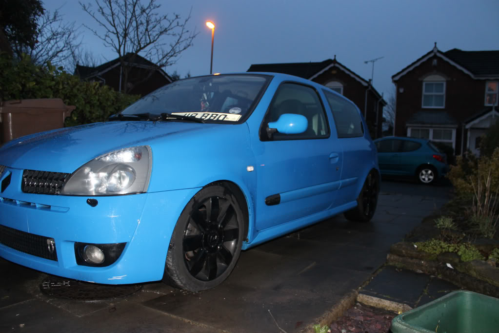

and one a found from a few week back that i forgot about

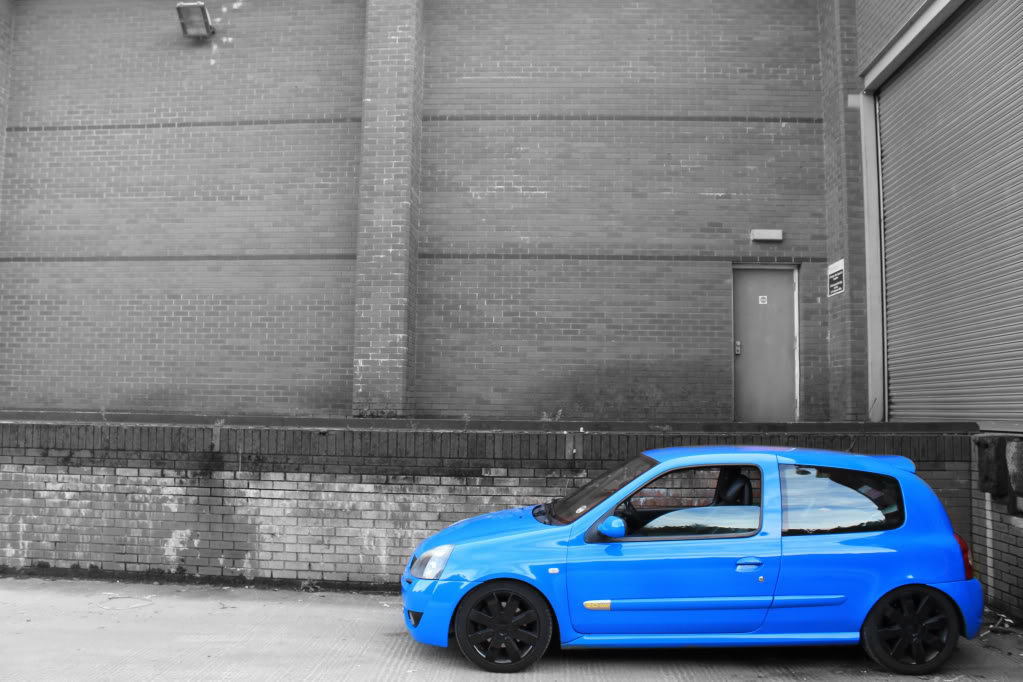

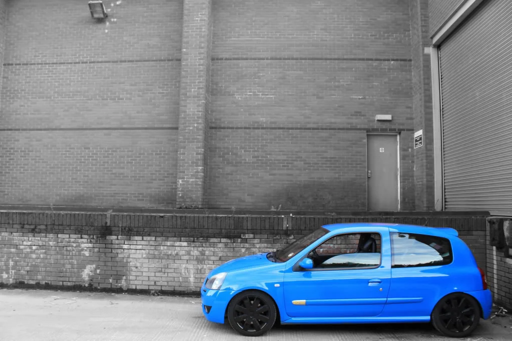

Really like the interior, but that number plate ruins the look of the car not being on the bumper!
Very 'McDonalds car park on a Friday night'.

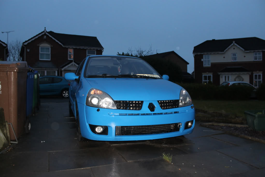

Scratched the bumper already? Looks nice but I'm not a fan of the black cup wheels or front bumper either, although it may look better with a splitter and the bumper cutouts replaced.

Looks good I think.
But if you've got black wheels. Those tires have got to be black too. Not brown

Ye very true, as you can see it got dark and late and tbh i was freezing lol

It was just on with a couple of sticky pads, not the best i no but its hardly ever driven, only done 3k since last jan, i work abroad and have a company car so you know. I did have it off for some time but after everyone on here said it basically looks s**t last time i uploaded a photo i thought it must just be me who likes it and stuck the plate on. But ye its off now as i wanted to show the bodyshop there is a crack where filling was done which you can just see, believe this has happened when the rock got stuck under my bumper and pulled and bent my bumper

Boot floor looks alright. Not a fan of "stripped" out rears and standard front seats though. Looks wrong to me.

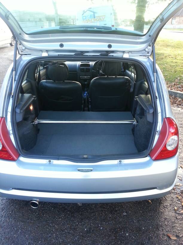

Wouldn't say it needs a guide really, very very basic joinery and upholstery skills really. Cut the wood to the right shape, cover with fabric of choice, done.
Yeah, I dont know how to put it, not really a guide more of an them showing me what stuff to use, Like i can imagine getting a wooden plank and it will make a heap of noise, just want to see what products they used to get it looking so nice

anyone going to post a guide?
Im going to do it but i have a feeling it wont look nothing like these haha
I had a large square of foam that i put it, cut around so it was the right size, then put the foam on top of the wood and cut the wood.
I then cut the wood into 3 parts to get it in and out easier.
I managed to get some sound deadening carpet and just used spray glue to glue it on, then stuck the foam templete under the floor to stop it ratteling about!
It was fairly easy pal took about 4 hours. Obvs remove the seats and everything else, then I just took the boot carpet out laid it down on some MDF from B&Q drew round it and then cut it out. Then the other part was just a rectangle, I got the carpet off eBay for 16 pound really good nice colour and thick. Stapled it down and glued it, the just stood it off the floor by about 60mm with some legs made out of the left over MDF
