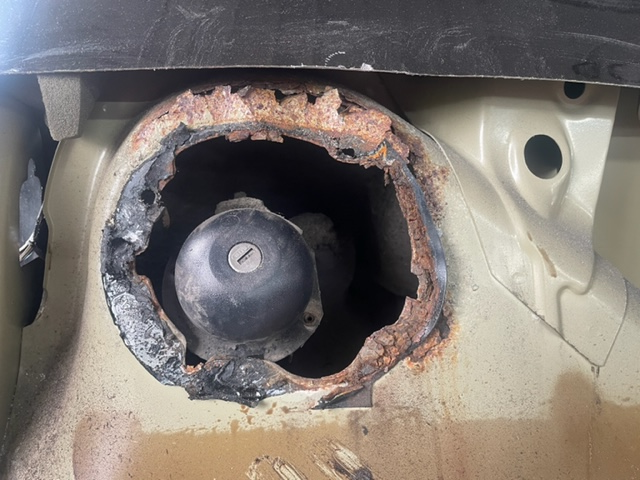

So, after a while of procrastination, I bit the bullet and decided to get the offside rear panel sorted. As most will be aware, the crap design of the fuel filler area and the lottery of the cill protection means that rust can be on a sliding scale of pretty much zero to a clump of brown metal filings.
I refer to this as being 'Part 1' as the nearside needs doing also. However, the rear arch was a lot worse for bubbling on the offside and along with the rust-ring surrounding the filler cap, both myself and the body-shop chose that side first.

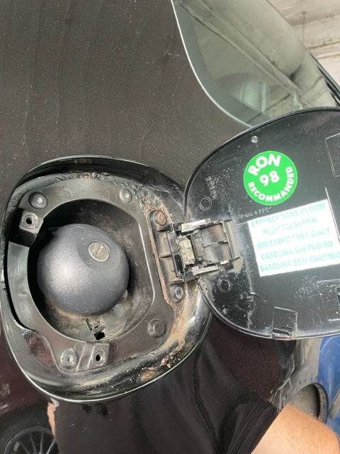

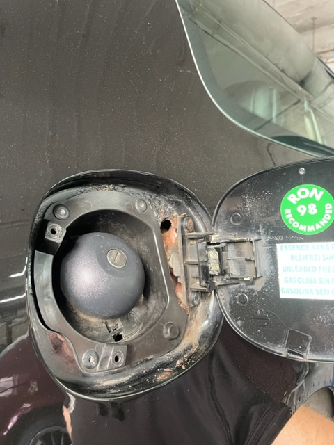

The filler cap on mine before work.

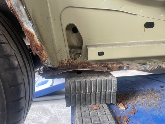

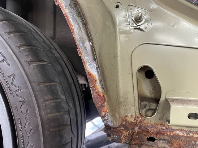

After a few prods - lol.
Bigger (literally) lol.

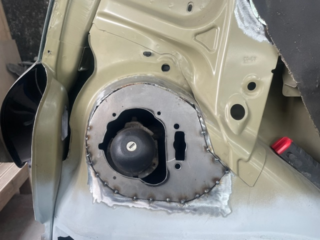

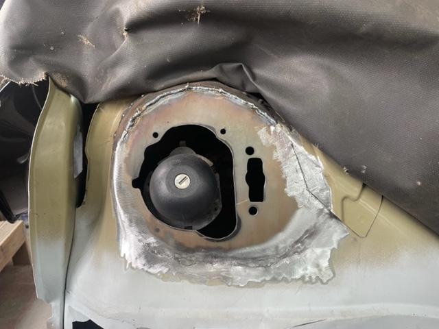

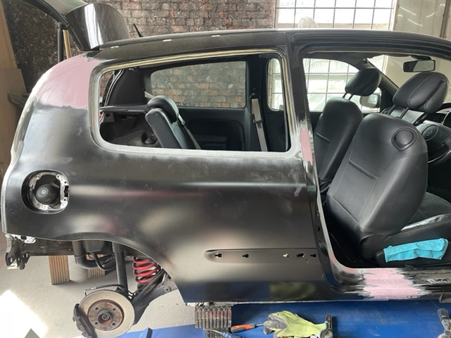

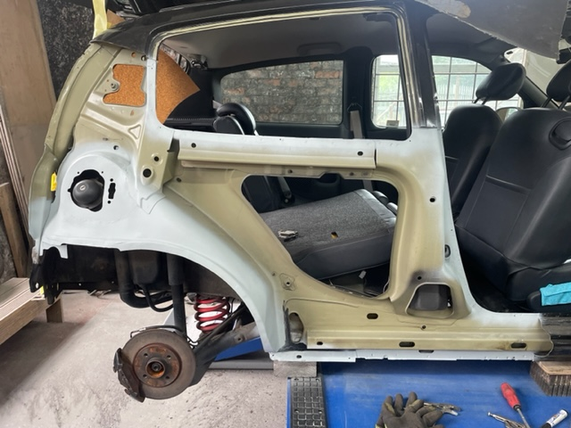

Start of the fabrication work around the filler cap.

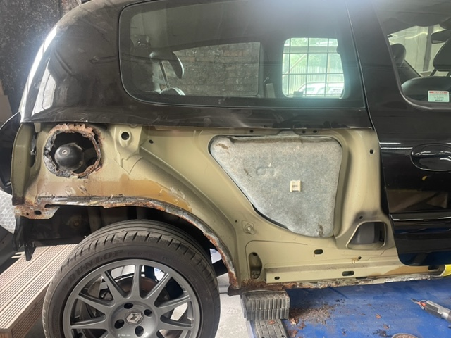

Cill area - not as bad as I thought.

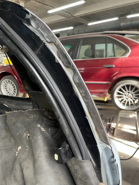

First section of the rear panel removed.
Getting sorted.
Cut line.

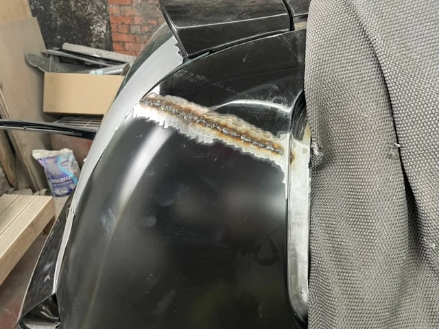

New panel fitment.

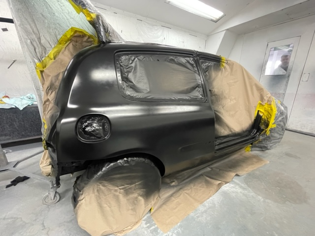

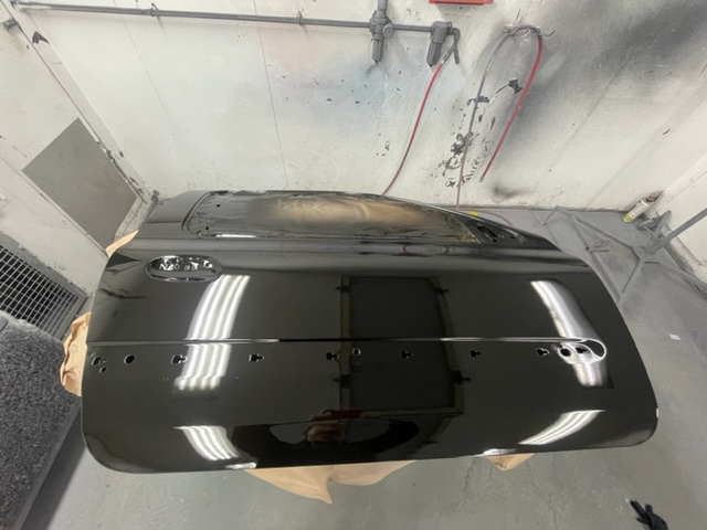

Paint booth.

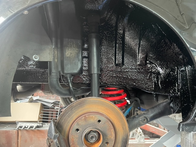

Arch area protection.
Door getting painted too.

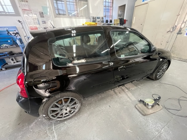

Almost done.
Finished article.
Overall, I was very happy with the service that Rob and Mark provided. So much so that I won't have any issues going back to them for Part 2 of the refurb - and potentially Part 3 when I get the front-end revamped too!
I've never had such aggressive bodywork carried out on a car before - so it was worrying at first. Thankfully, all turned out good and the 'ol girl continues to bring a smile to my face when I drive it. :)
