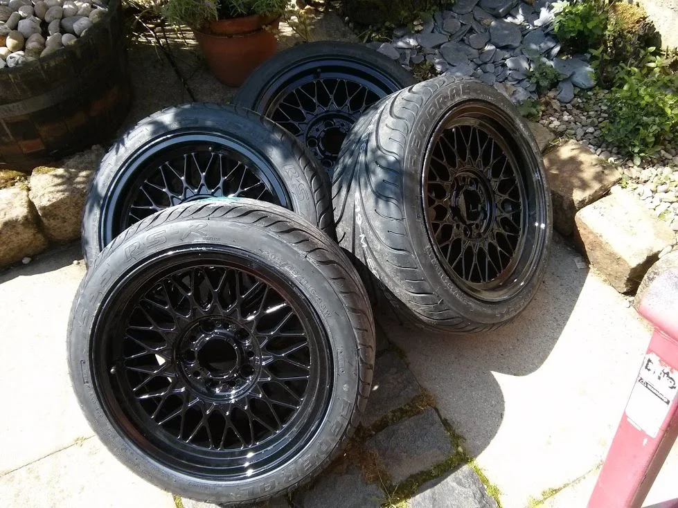

you can send set of wheels in two boxes at the most, no need for a pallet. be wary though as some coaters are crap with non industrial stuff/finishes...as you've discovered:wink:
Tilling are decent, I'm sure @f0xy @Jonff @Joe# have used them.
Yeah, actually related/family
Will do anything really - can do them with tyres too but £10er extra to remove+refit/balance per wheel.
