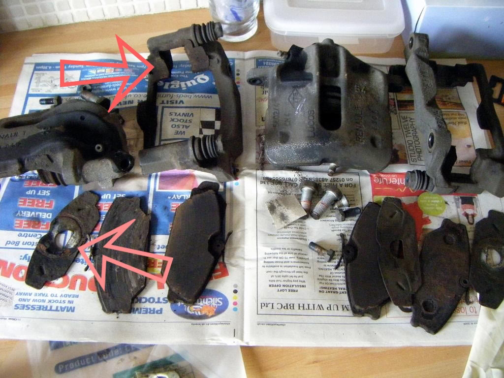

so should the shims in the carriers be removed i fitted these pads and mine seem to be constantly riding the disk even though i have moved the pad away from disk it still ends up pushed upto it with no gap between pad and disk anyone help?

was just on to the guy that fitted mine and he said he removed all the shims as the pads wouldn't fit otherwise

when looking at the pad and disk from above surely u should be able to see a gap between the 2? on mine the pad is right upto the disk and seems to be causing constant wear as outside pad is wearing alot faster then inside. Probably bout 1/4 of pad worn in just over 3 weeks?

there's only 2 shims per pad carrier, no shims on the pads, just the pad springs (they stay on)
Not the pad springs fred. Mine had sort of backing plate plate. A piece of metal between the pad backing plate and the piston. This was the same on both pads.

Fred, you mention filing down the ends of the backing plate and removing the shims, however, I have done this and yet they still bind.
The squeeling and constantly worrying about the heat from the disks is getting on my nerves!! There is about 1mm to 1.5mm of vertical movement in the calliper now, but do I need to remove any more?
If there is no other method, what other aftermarket pads fit straight in and don't need filing? The shims are slightly bent so pads that don't need them will also be a bonus.
