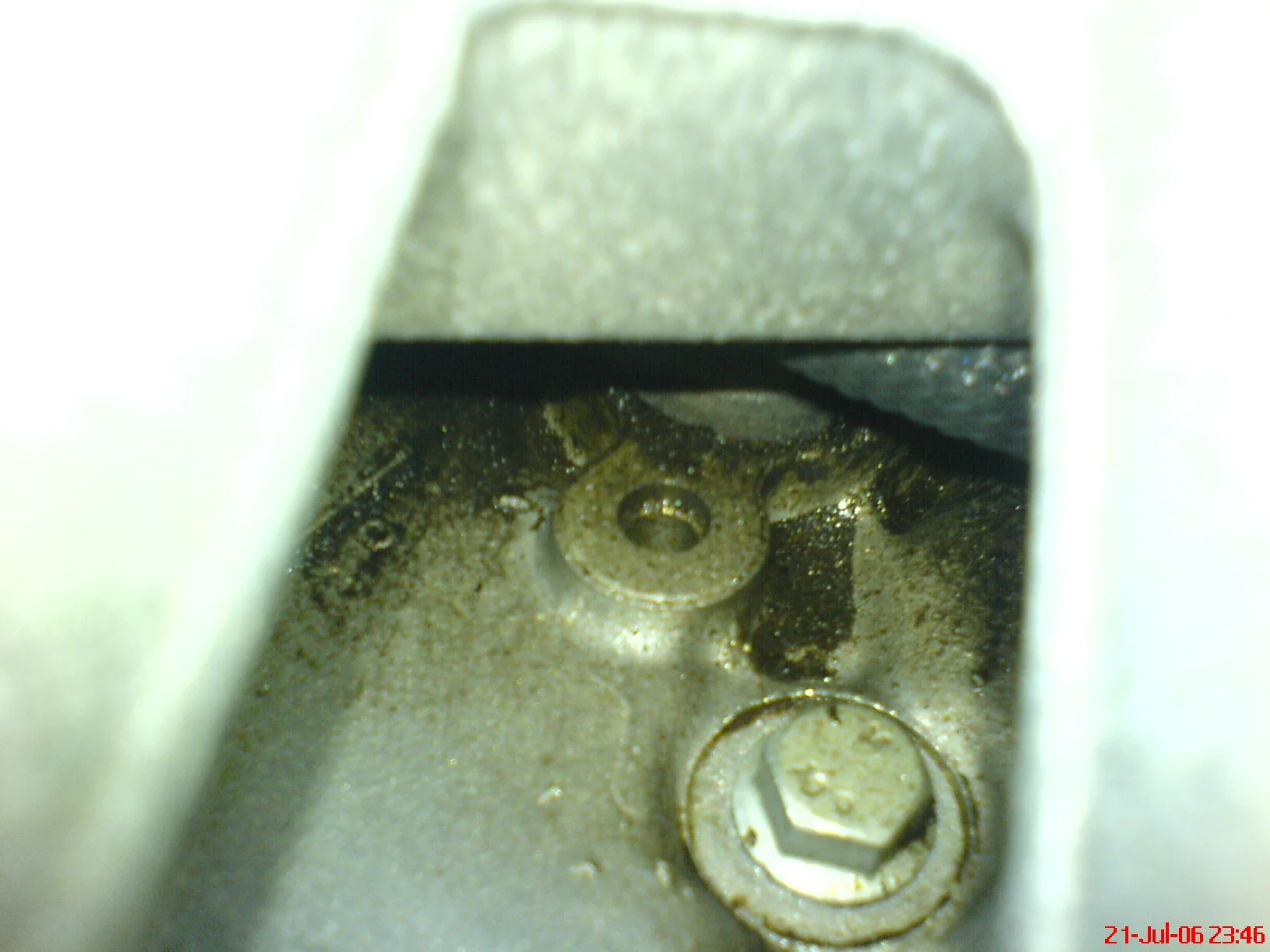

I just went out there to take a couple ben hope your impressed! Anyway this incident has really soured my experience with my once beloved car. Im now thinking about selling.. :(

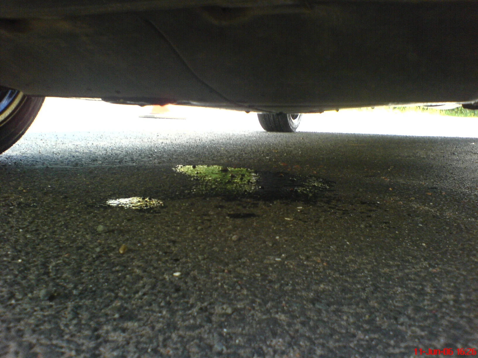

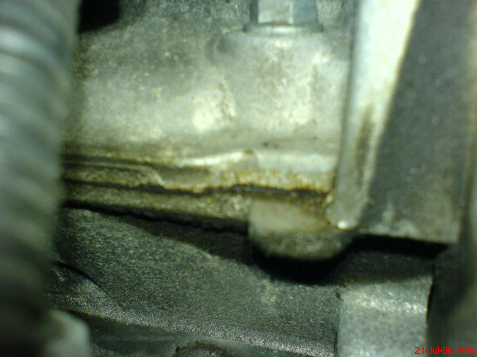

Here are two pics of the engine and two of my car with the best and worst bits! :(

Thats the cam cover yes, common problem.
It doesnt look 'fresh' fresh though, lots of grit and dust.
As for where your using oil, its hard to say.......if its physically leaking and you can notice it using oil, there will be a large mess in the area its leaking.
How much oil and how often?

Fraser very common indeed, been sorted on mine too.
