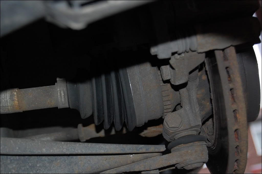

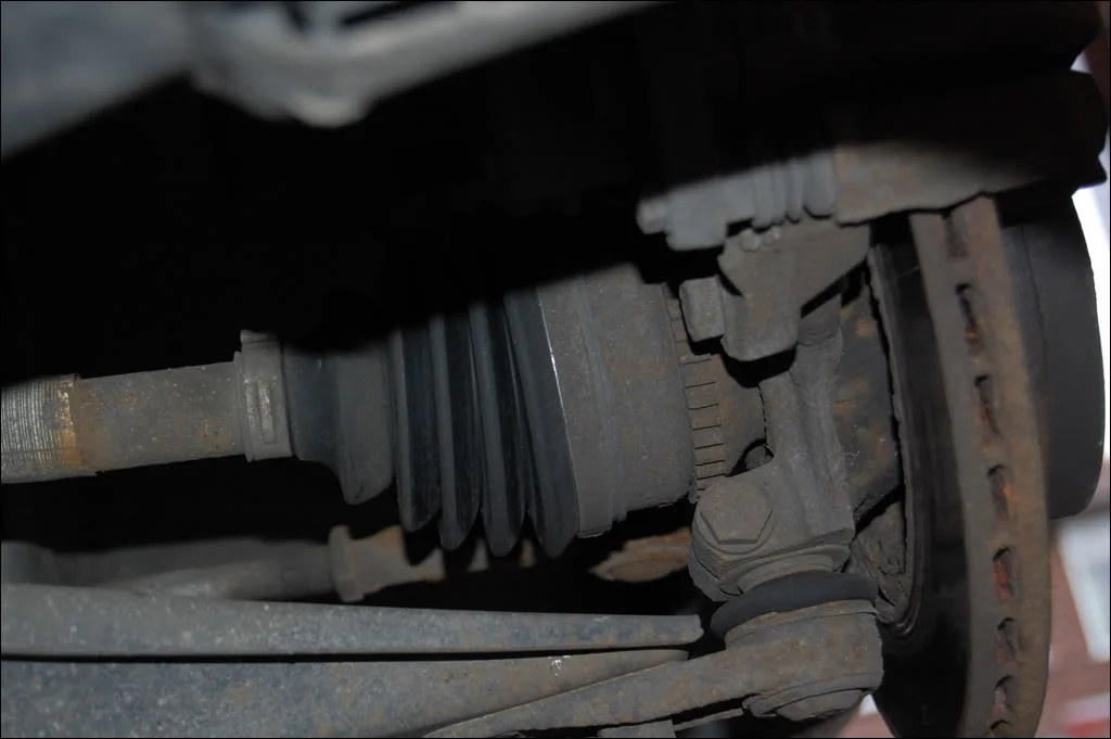

Near side;

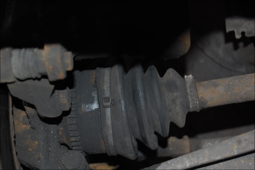

Off side;
The offside has no pressure inside. Which makes me think there is more than likely little to no grease inside. The cable tie is no where near strong enought or tight enought. Can push it back and too but I wasn't in the position to start destroying things today and take it off. Just going to get a new one.
