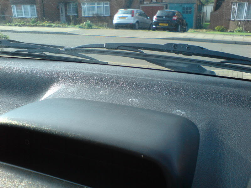

Rich I need your advice on the best way to remove these glue like patches off my dash. They've been there since I've bought the car and I believe it was some sort of sat nav device that must have been placed there but just taken off before I bought the car. I've scrubbed it with a scourer but it just makes the old rotten glue turn a whiter colouration.
I want to remove it but without scratching my dash.
Any suggestions?
Cheers in advance

Glue and tar, otherwise I found that windscreen wash does a great job at removing adhesives, it is a solvent after all. Just make sure to wipe off and apply some dash spray once you have done.

AG Tar and Ahdesive remover, try in a hidden area first, then wipe away the residue well and dress the trim.

Once you have the glue off dress with Poorboys Natural Look Dressing, top stuff and comes with a seal of approval from Rich ;)
