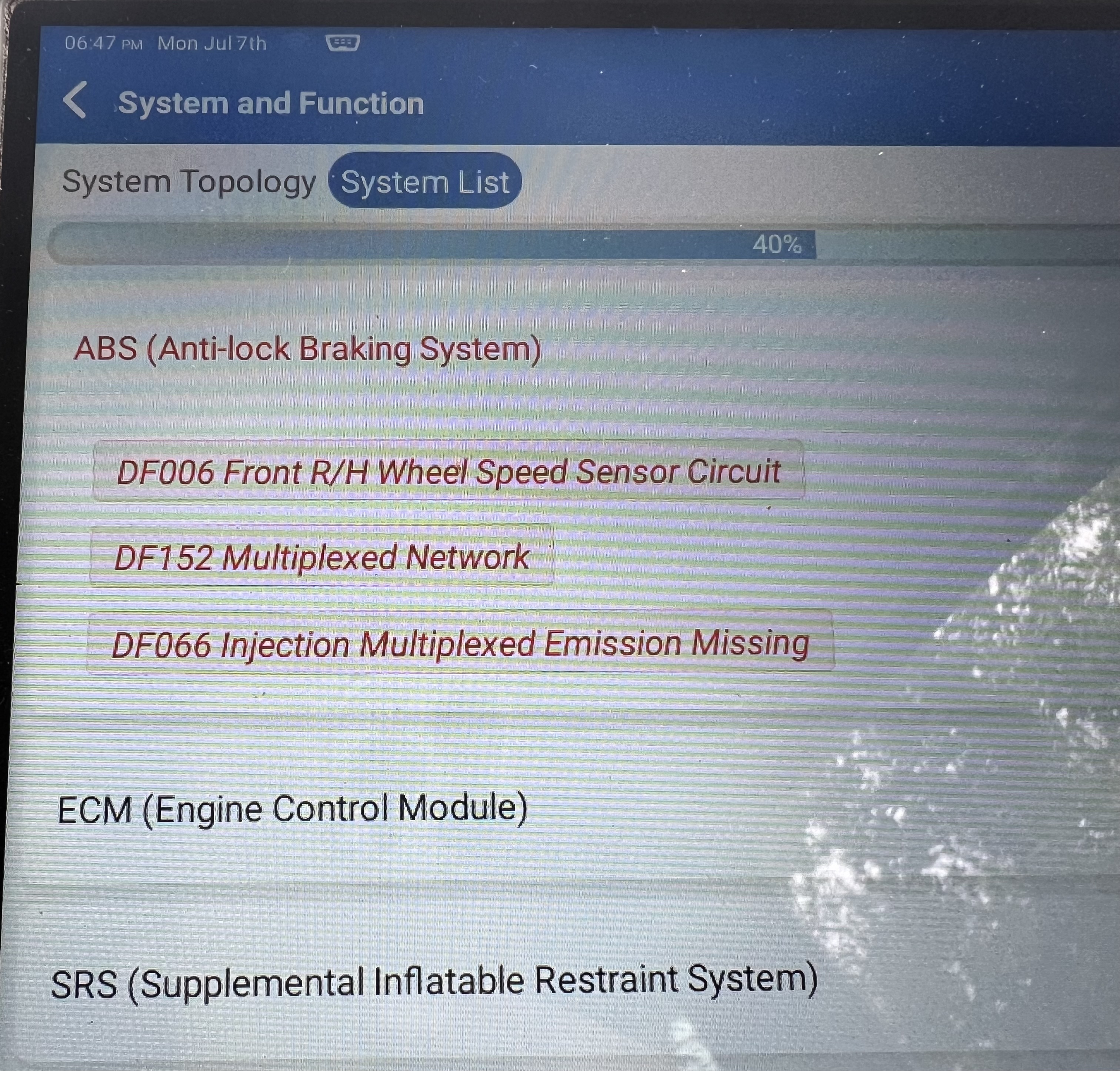

Digging this old thread up, i have a DF006 code coming up but doesn’t look like it’s related to the knock sensor as above but a wheel speed sensor circuit.
I’ve changed the ABS sensor, ABS ring, disc and pad on the right hand side. Tried to clear the fault but it’s not budging. Any help would be appreciated.
TC.
Just for reference for anyone in future looking up DF006 fault. It was showing up as R/H fault on the computer but turned out to be L/H. Replaced and all lights cleared.
