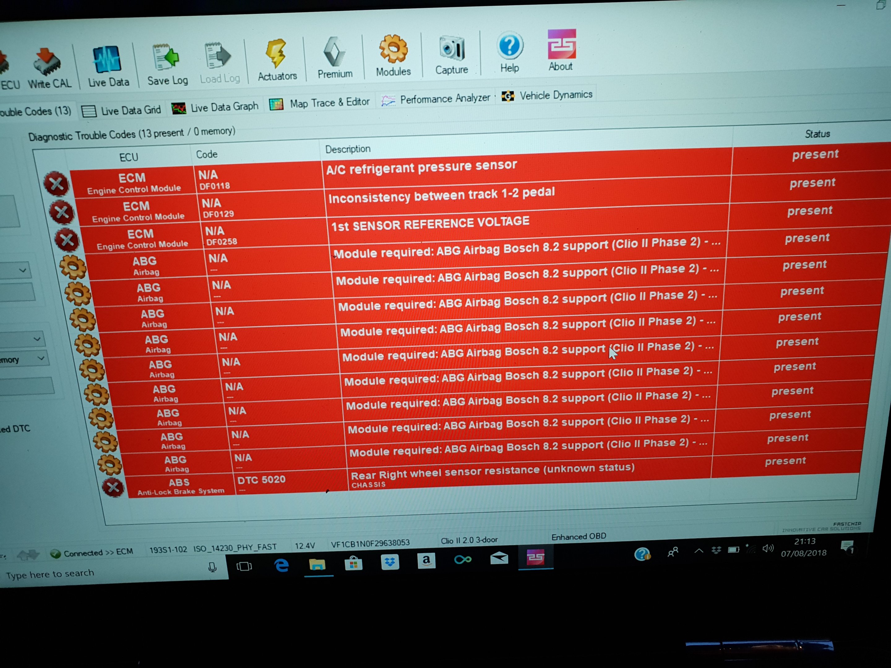

Fault codes , see my photo
  clio 172
Got afew fault codes , removed air con , so assume that's the first code . Airbag will be due to aftermarket wheel and bucket seats . If u buy airbag software, i can turn those codes off ?
Can everyone explain the others ? ABS RING on rear ? They are new Renault rear discs

  clio 172
My car has been off the road along time, rear discs are new but been installed afew years. Would it be the sensor or maybe a faulty caliper ? I do recall one being tight
