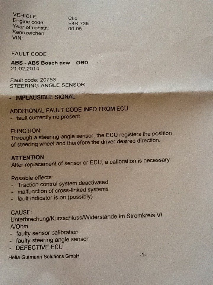

Fault Codes, steering angle sensor?
Just found this out what I forgot about, my car has the traction control / abs / service light on.
This started from when I got the car back from a gearbox change. I don't think the abs light was on at first I think it came afterwards but I'm not totally sure.
What do you think needs doing, steering angle sensor replacing? I wonder what could have caused it seen as its not even been touched in that area.

Need to see the live data and go from there mate. It could be a config issue if it's been off recently or it could be a clock ring ffault and so needs replacing.
