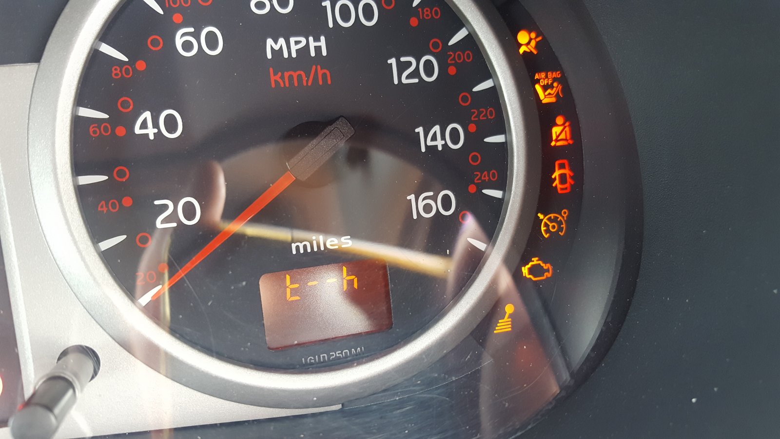

engine light came on today whilst sat in traffic. did the ignition test and came back with T--H

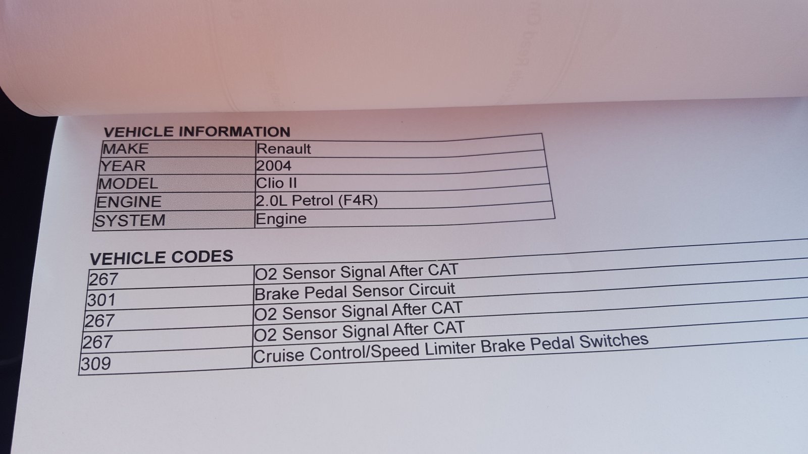

local garage used a expensive snap on code reader and i got these faults listed
the code reader cleared the faults and so far the light has not came back on.

Don't suppose they told you which were 'active' and which were 'memory/stored'?
Would have helped to narrow down what's causing the light to come on as stored faults could well have been logged a while ago and haven't been erased, whereas an active fault is current at the time of testing
he didn't mention anything about which codes were active/stored

EML light came back on last night!!!
I'd been out in it for 2hours plenty of hard driving with no problems at all!!
get home and park up and the EML light comes on??
