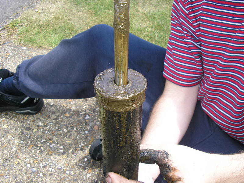

when i was going round roundabouts it felt like the car was going to slide out. it was almost like that dropping feeling you get in an elavator. the left rear shock had gone. changing it stopped the problem.
yeh it felt like a twitch and yeh like the elevator thing....so im guessing general consensus is leaking shock...because the other side looks new but the dodgy side shock had oil on it and looks old so it coul be leeking...thanks guys :)

i had the same problem in mine gets quite scary in the wet i just got a new pair of dampers and that solved the problem for me
lol like the picture...the funny feeling side's shock looks like what you have in the pic and the other side looks new. ive got my car booked in tomorrow to get the shock changed so i'll let you guys knw if it fixes my prob

Could be a leaking shock
I had the same issue! lol . when i first bought my Clio when corning the back end felt like jelly and as if it would lose control and skid out... turned out it was a leaking shock... replaced both rear shocks and it has been perfect ever since!
