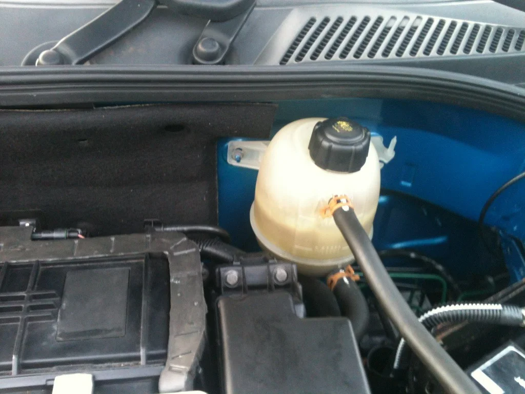

I opened the Bonnet today an Looked at this bottle. From what I remember... It's been well over a year since I've looked all this up... But this bottle in the picture below is practically empty. Which is this for, the radiator top up?
Actually looking at the bottle in this picture it looks just slightly under half way full. Since I had the car I've always assumed by looking at it that this is the case. Only today, after shaking the car about and not seeing any movement in the bottle I opened it up to find only a slivver left in the bottom. Now I know this should be near full to run at it's best! But no where near.
What do I fill this with again? Is it some kind of coolant or water or..? I'm assuming it's the radiator? I'm thinking this could be a cause or...??

The water should be between the min and max lines on that bottle. It's the expansion tank for the coolant, which at this time of year should be an appropriate ratio of coolant/anti-freeze to water. Water will do for now to get you to a garage. Fill it to max line .. run the engine .. keep an eye on the levels.

Ok so it is actually water I fill it up with? Surely I wouldn't need to take it to a garage just to fill up the water expansion tank? as the sensor can wait till after Christmas an holiday in December which is making me skint! As I know I need to get this filled as soon as possible, I'll be getting it done tomorrow. I just hope there is no damage done....

You need to give it to someone who knows what they're doing as the water doesn't just disappear. It's a closed system.
There's a problem which means the water is going somewhere it shouldn't.

Yes fill it up with water to the max line. This should solve your erratic engine temp and weak heater. You will need to test the antifreeze level before it starts to get really cold but you can worry about that later since if the coolant level has dropped that much is means there's a leak somewhere.
You can often spot the leaks by it either being wet of course of a white crusty residue somewhere but I'd let the garage sort that out. Obviously let him know the coolant level was very low when you got it. (Might want to take note of the exact level when you top it up with a mark or something so you know if it's still losing coolant).

So I have gone ahead and topped up what was in there originally. It was a yellow colour so there was some in there.
Idle'd it for 5 mins and rev'd it at 2k for 30 secs and waited until the temp gauge went up, which it did! Didn't go down this time. So I took it for a drive and the temp gauge went down as normal but so did the heater, i must admit it is a bit hotter than it was before, I will give it a bit of time to circulate I guess, that's if it wasn't full of coolant already, which I'm assuming it was because there was still a little left in the bottom, not bone dry.
