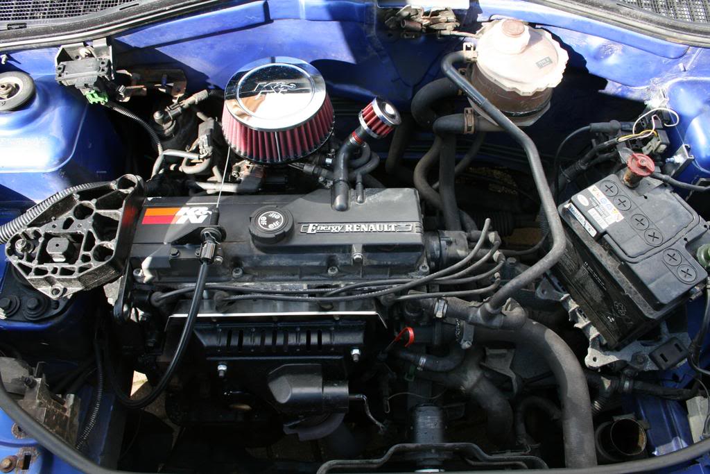

Oh n this is the engine, duno if it helps:
