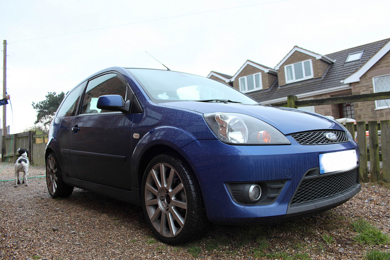

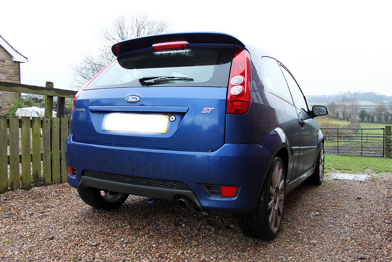

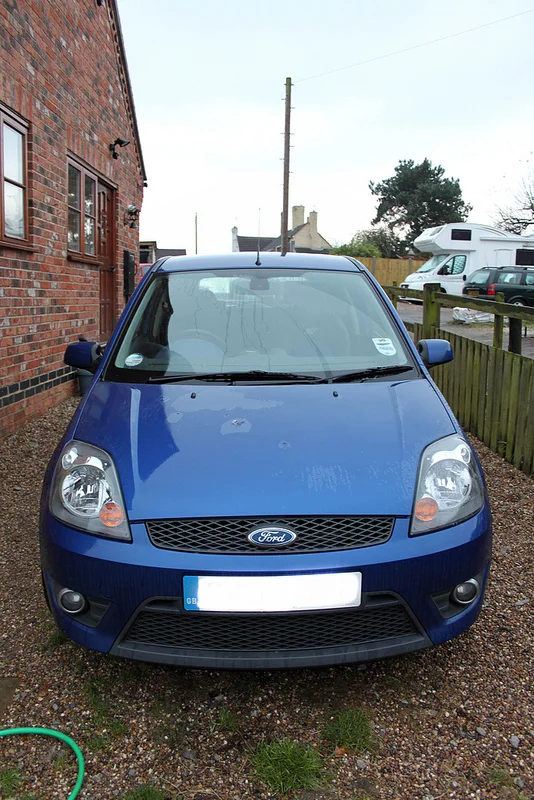

Before:
1/12/12 Fiesta ST Detail - Before by Harpham y0, on Flickr
1/12/12 Fiesta ST Detail - Before - No Beadage by Harpham y0, on Flickr

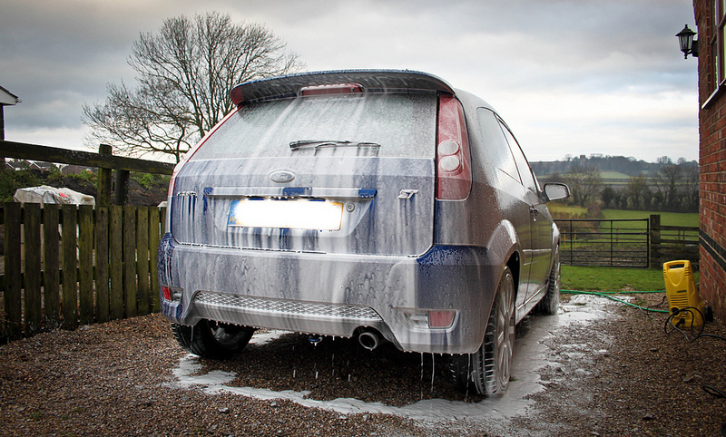

Snow Foaming:
1/12/12 Fiesta ST Detail - Snow Foam by Harpham y0, on Flickr

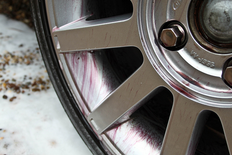

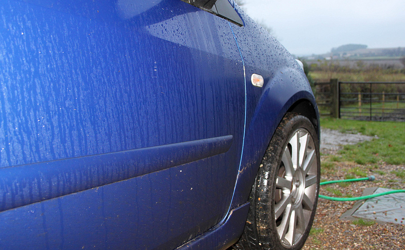

Iron-X:
1/12/12 Fiesta ST Detail - Iron-X by Harpham y0, on Flickr

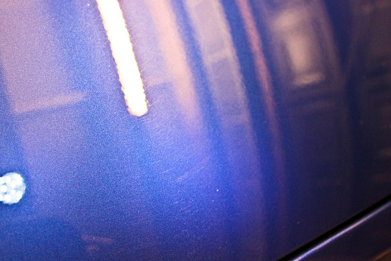

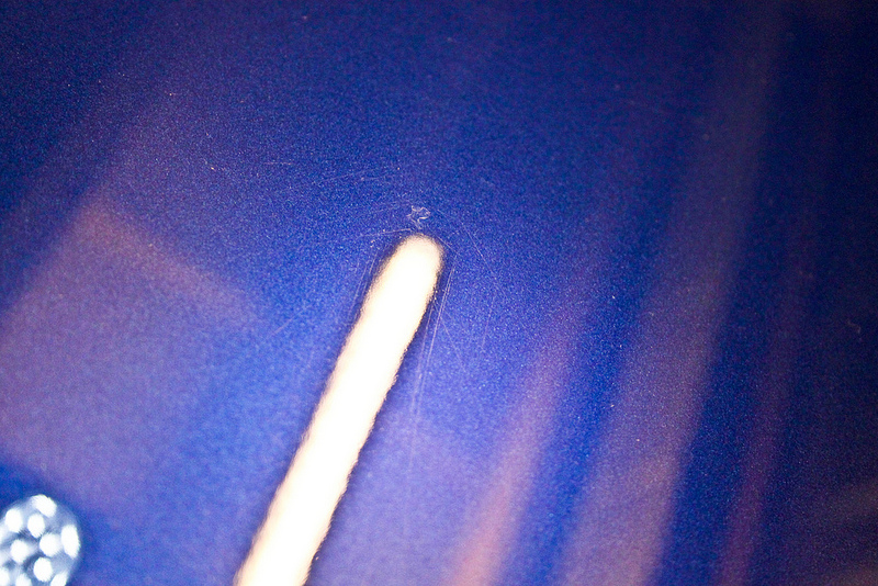

Taken into the garage and inspected the paintwork. The car was covered in light swirls and loads of RDS. Was really hard to get good quality photos of them though, but here's a couple that slightly demonstrate this.
RDS:
1/12/12 Fiesta ST Detail - Plenty of RDS present by Harpham y0, on Flickr
Swirls:
1/12/12 Fiesta ST Detail - Light Swirling all over the car by Harpham y0, on Flickr

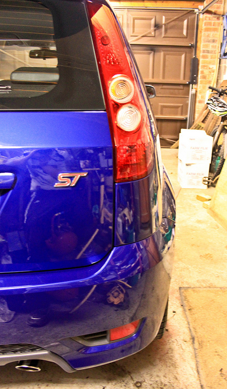

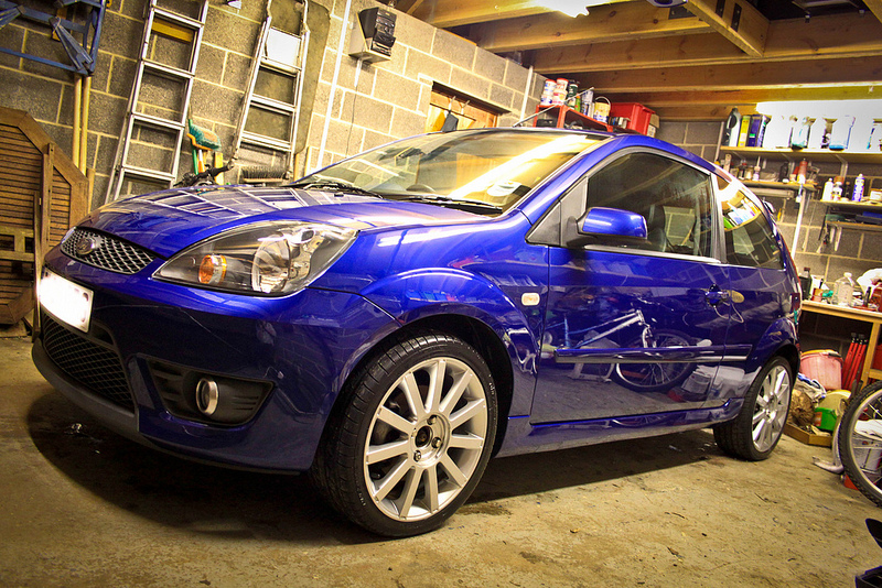

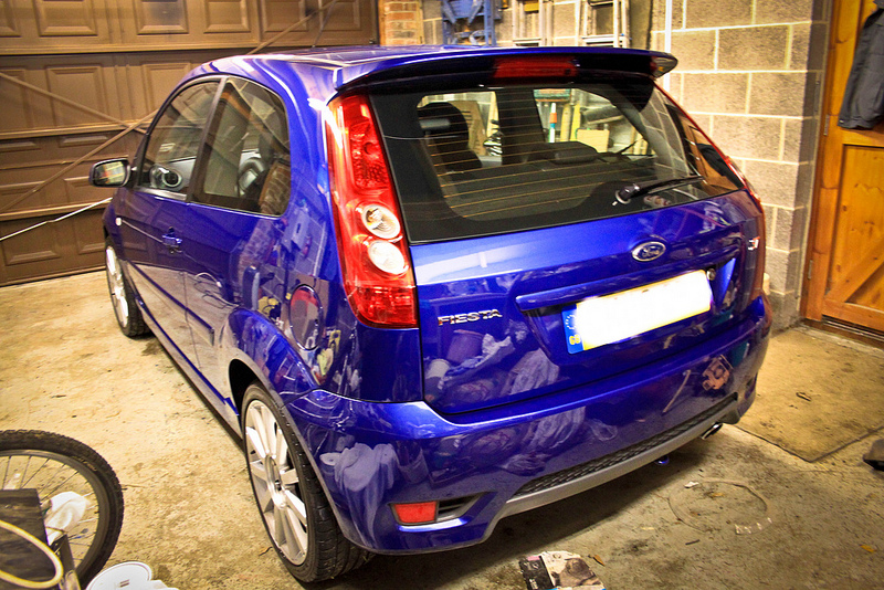

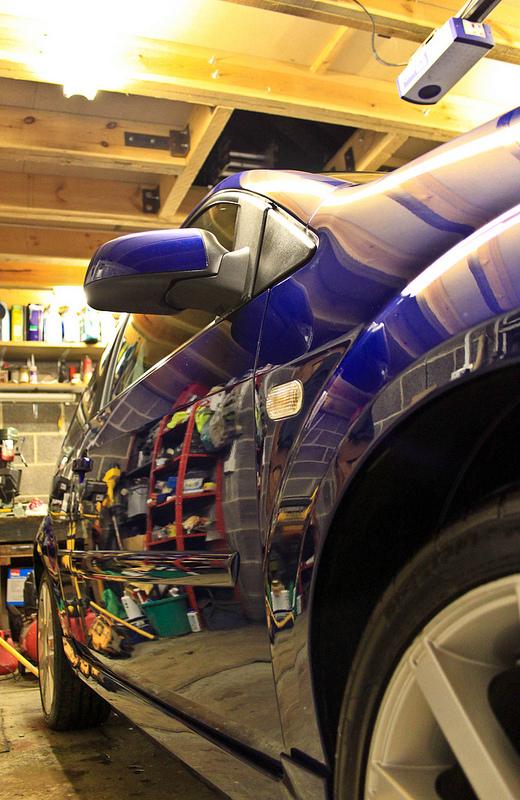

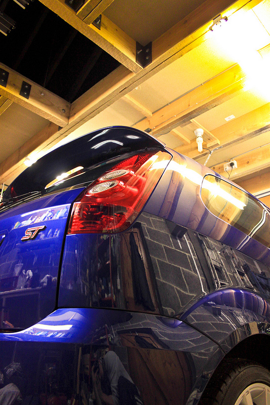

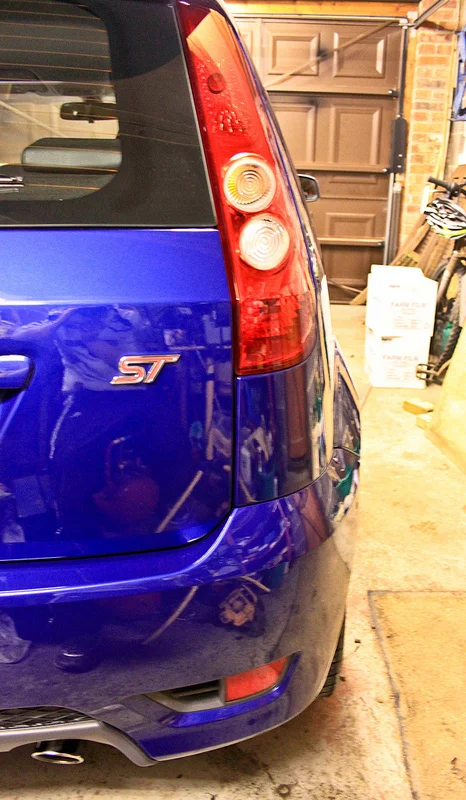

After:
1/12/12 Fiesta ST Detail - After by Harpham y0, on Flickr
1/12/12 Fiesta ST Detail - After Reflection by Harpham y0, on Flickr

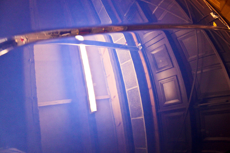

Swirls gone:
1/12/12 Fiesta ST Detail - After - Swirls no longer present by Harpham y0, on Flickr
