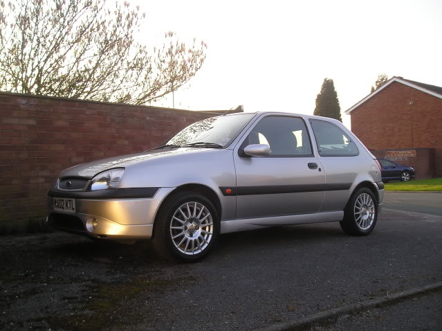

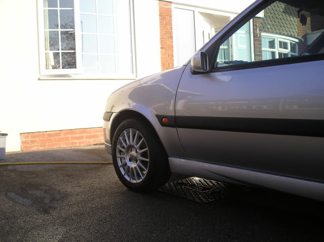

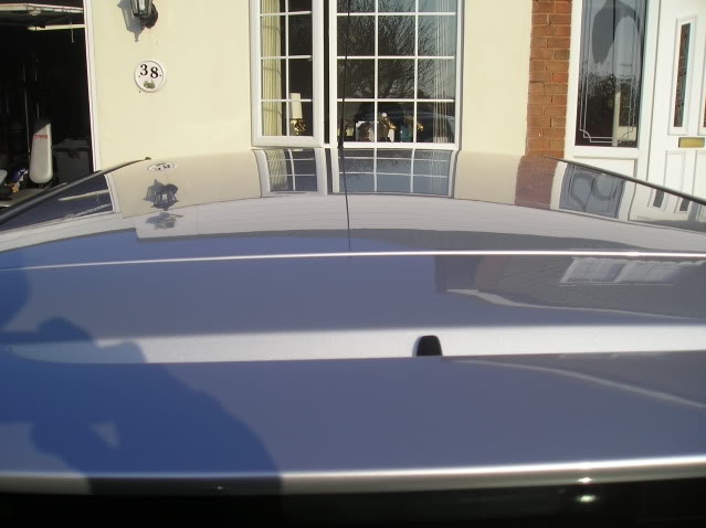

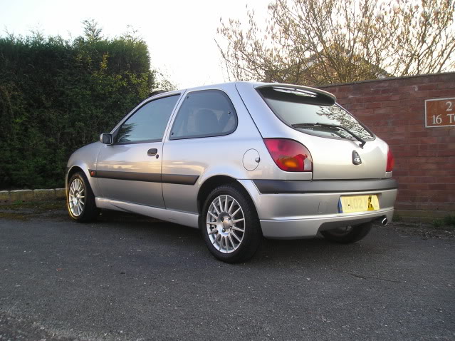

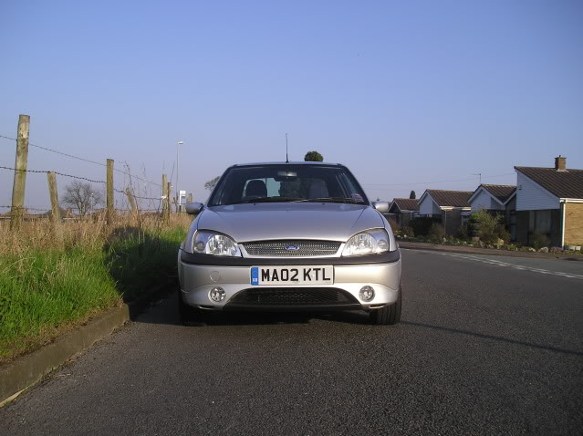

Amongst last weekends lovely weather I thought I'd give the Fiesta it's first proper clean since I've had it.
Process for the detailing geeks as follows:
-Wheels and tyres cleaned with G101 and Bilberry
-Car washed with Chemical Guys 'Glossworkz'
-De tarred with Tardis (vile stuff but good at what it does)
-Clayed with I4D clay and Born slippy lube, wahey
-Washed again quickly
-Taped up with 3M
-Menzerna 106fa and Dodo Juice Lime Prime used on a Sonus SFX-2 cutting pad with the Kestrel DA.
-Waxed with a Raceglaze 55 sample (Cheers Russ)
-Tyres dressed with Pinnacle Black Onyx (best stuff I've used so far)
-Trim dressed with AG bumpercare
-Glass polished with AG Glass Polish
Final wipe down with Chemical Guys speedwipe.
Unfortunately after all that I couldn't take a decent pic :lolup: heres my best efforts:
Let me know what you think,
Alex

Looks great Alex, want to do mine? Lol.
De-Tango'd the headlights I see, too :cool:

Aye, will look very similar, only difference being the front grille. Yours does look a minter!
