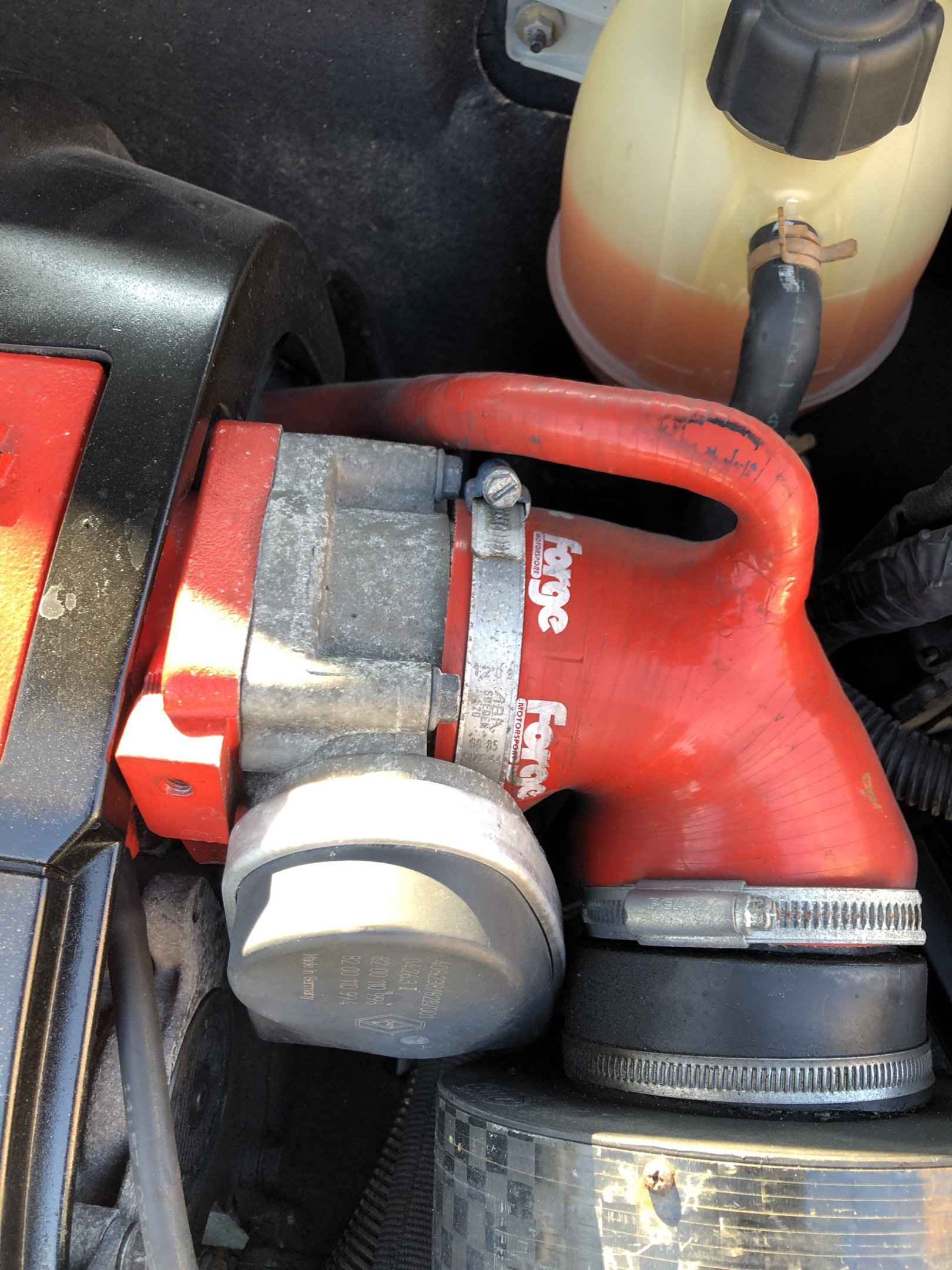

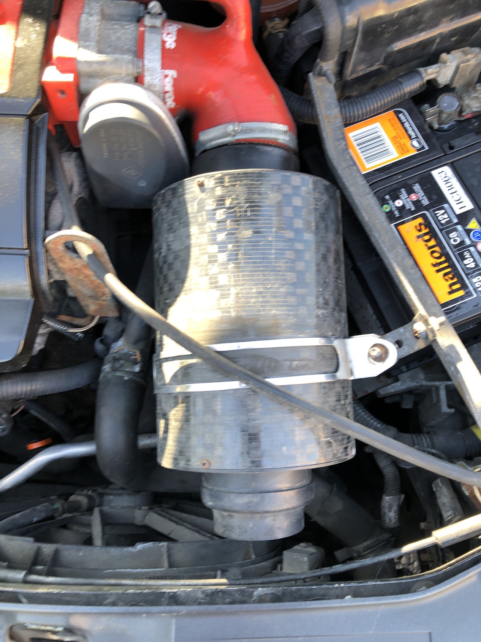

But back to the Clio someone has proper crashed through Halfords there’s cup 172 stickers stuck on the side of the doors (even tho it’s a 182) there’s a carbon filter housing the size of the steering wheel under the bonnet and is connected by a forge motorsport pipework. And where the jubilee has been done up so tight it’s cut through the pipework. As I said it’s abit pickeyd up. I want to still get a open air intake for it, but don’t really want to spend more than 50-60 quid any idea on brands etc

Which forge motorsport piping? If it's the one with a breather that's worth ££
  Clio sport 182
No clue I have loosened the clip since this and it looks like it was just flat not split

Ok so after cleaning the filter up and can live with it sorry bud, I also went to go and do the spark plugs and noticed that the inlet manifold bolts were buggered!!! They required me to heli coil 3, I have fitted a thermo tech gasket after cleaning up and making sure it’s clean but it seamed to be leaking on the right and left hand side. I then used some sealant on top of the gasket and seams a lot better. I’ve just got to do the clutch cable looks relatively simple just fiddly at a quick look.

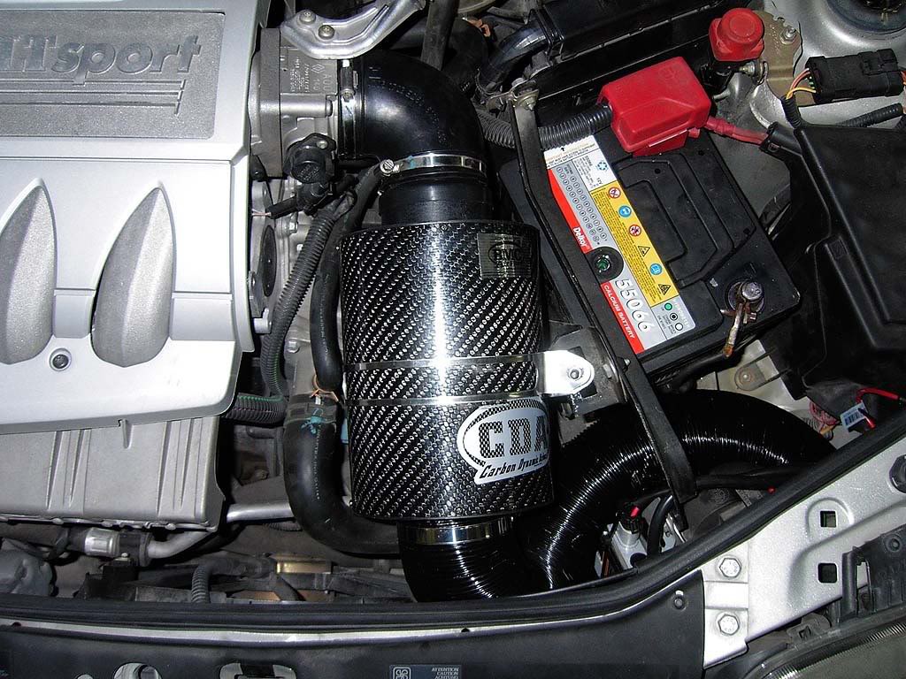

Not sure that is a BMC CDA... Looks like a cheap Chinese copy to me?
