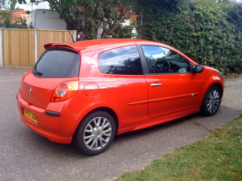

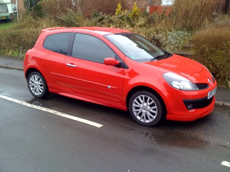

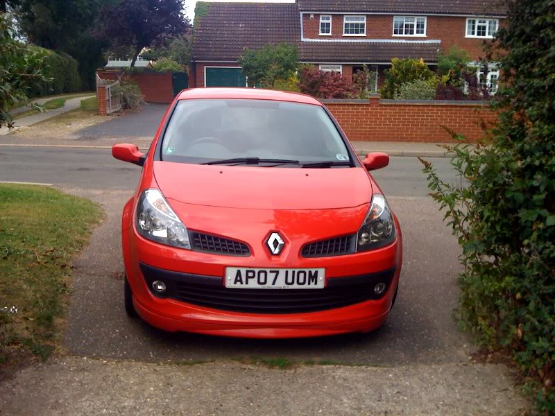

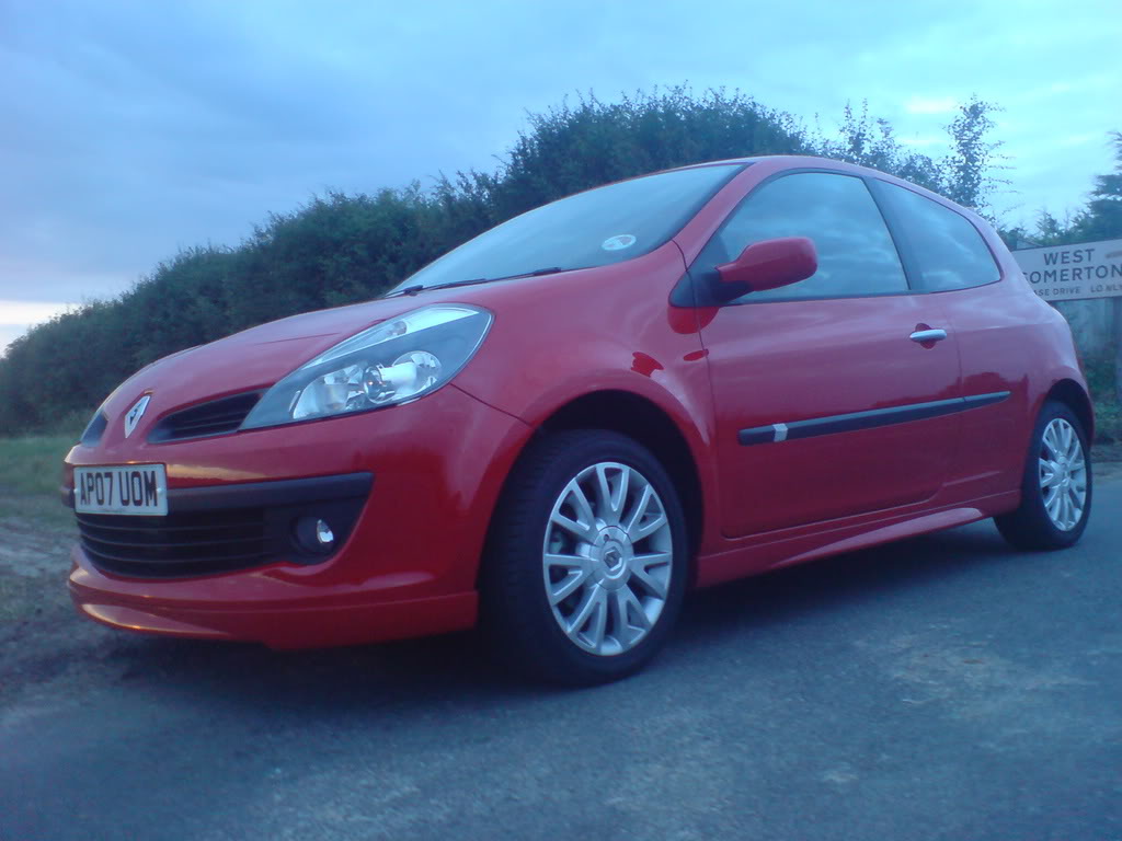

Finally done it:) only 30mm but am glad no more since I've already heard it bump over speed bumps lol! loving the difference and stance compared to standard since i've nether driven a lowered car.
Big thanks to renault_wizz for fitting!
Before:
After
Comments welcome and shall get better pics soon on my camera as they were on my phone.

20/25mm spacers now and itll be good. 30mm isnt much though is it !!!???
Whats it sitting on, prolines ?

Lol as said your nether happy unless it's scrapping the floor! Personally I love the difference and glad I didn't go lower cause it already scraps on speed bumps as is.
Not much difference either way seems pointless to spend the money for no noticeable difference at all

Does look lower, your blind/lieing/being anal if you think it doesnt, very subtle drop, but its there :)

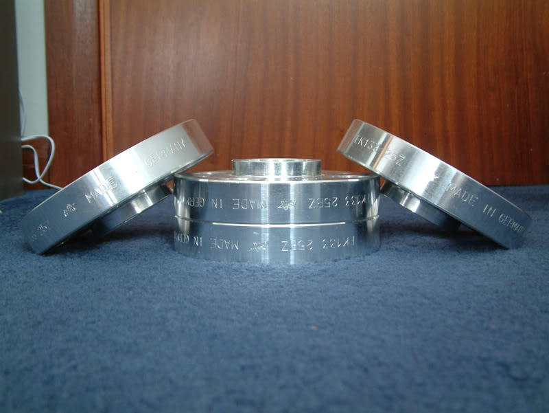

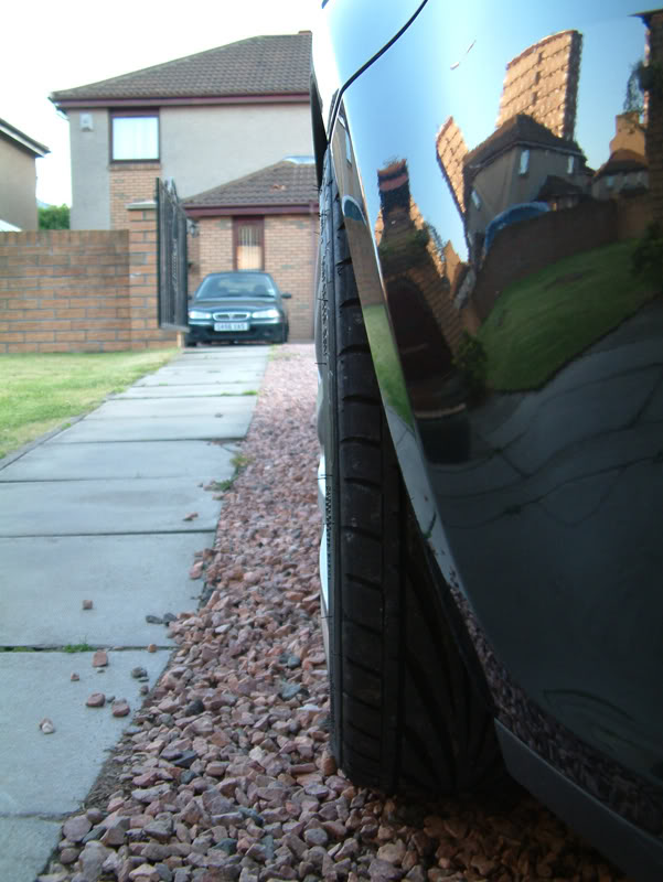

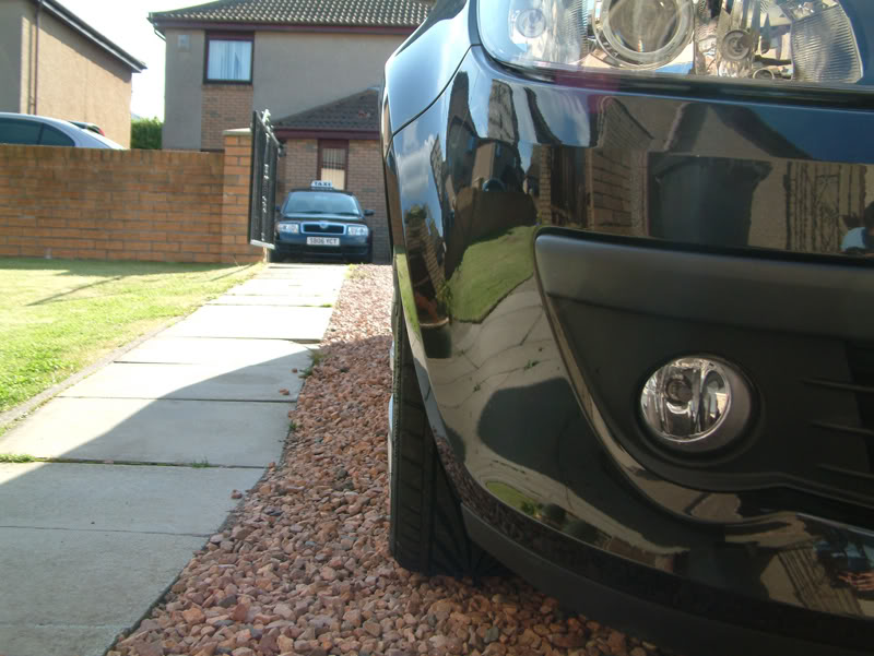

The system B ones bolt to the hub and then the wheel bolts to them..
30mm per axle (15mm a side) is the smallest you will get in system B spacers IIRC.
Smaller requires system A.
System A use longer bolts through the spacer and the wheel.
Some people think B is safer, which it probably is..
If you get either, make sure their hubcentric as this takes some of the load of the car off the bolts, and onto the hubcentric angle and also makes sure your wheels bolt on straight. If their not hubcentric, don't bother!
I find my spacers made a massive improvement in handling, the car feels totally planted.
I researched a lot online and thought they would make it worse, but boy was I wrong! :)
