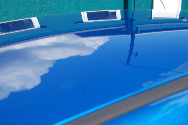

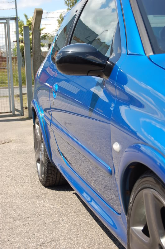

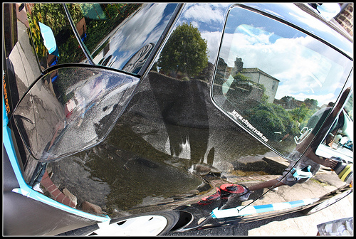

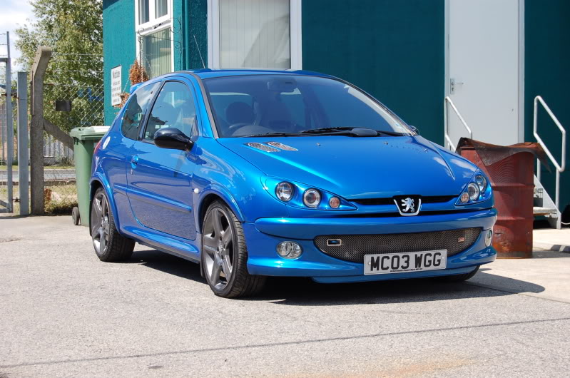

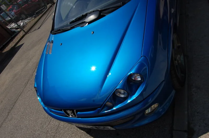

Decided to do my mates 206 GTi 180 as he's selling it now and it needed to be de-swirled badly.
The paint turned out to be a right arse so i used 3M fast cut on it, finished and refined with IP and Final finish. 100% Swirl correction was pretty epic tbh. All topped off with some P21s as it works great on Blues.
Total time 9 hours.
No before pics since you've all seen swirls....
If anyone near East Yorkshire wants theirs doing drop me a PM.

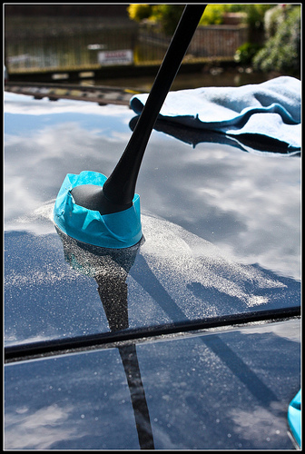

Impressed that you managed it in 9hrs. FCP is a difficult compound to work with due to the extended work time and dust! You using Rotary aye? I would of thought IP was enough cut on froggy paint.
LOL at Dust. f**king loads of the stuff. It looked like it had been snowing in his workshop.....
IP just wouldn't work fast enough. Using FCP saved a lot of time in the long run tbh.
No rotary just a random orbital sander i've adapted. It has a smaller orbit so it acts like a Rotary but its a bit safer.
After you had finished polishing did you wash to remove all the white bits?
Yeah a quick jet wash to removed the mountains of dust. Also got some 'Polish remover' from landrover for the plastics. Works great.
