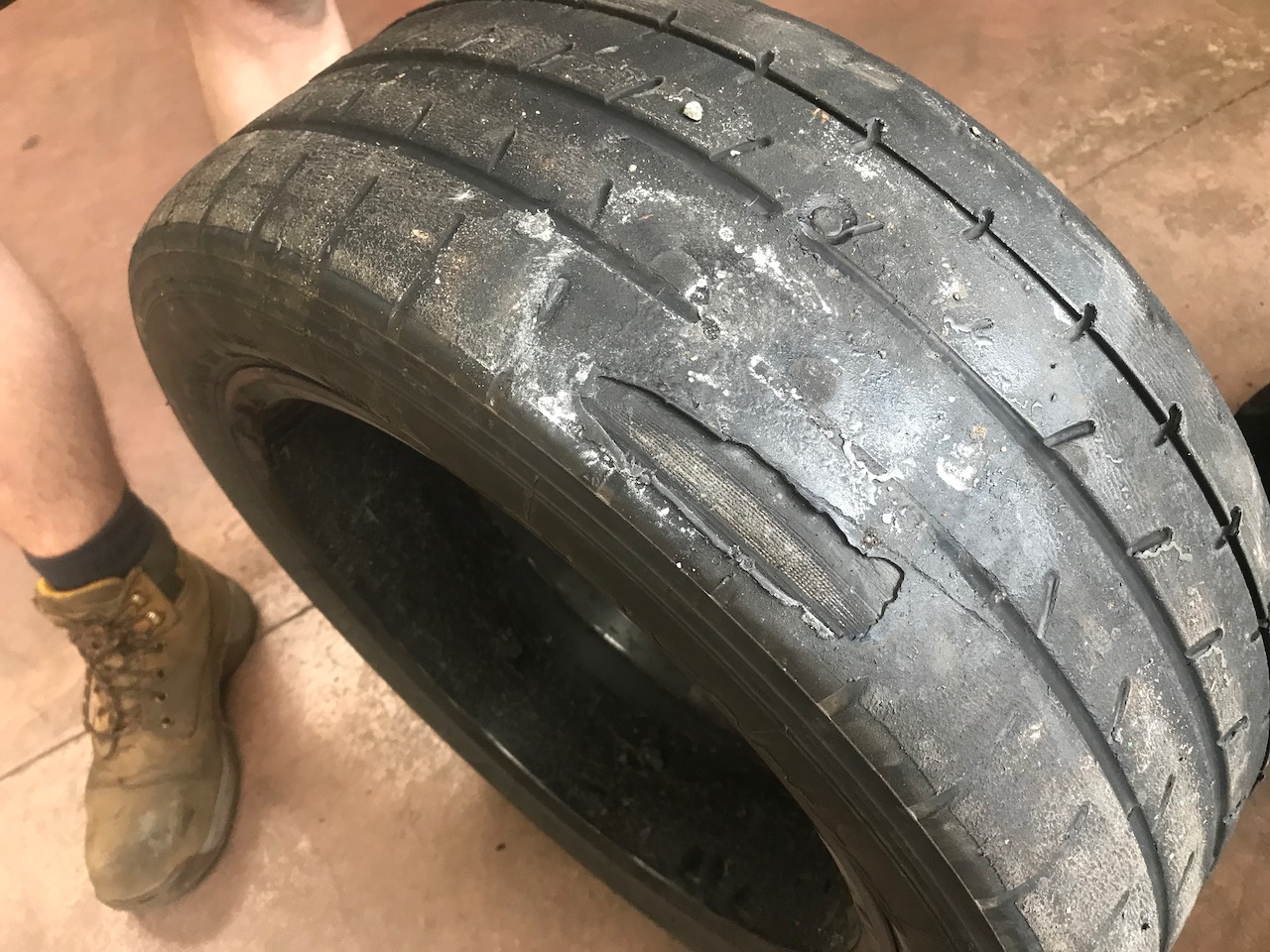

I used to be a big fan of the A050's until I used the 52s. My first outing was at Cadwell and i hadn't adjusted tyre pressures and camber, resulting in this. That's one trackday. They don't have a reinforced carcass like the 50's so as soon as they hit the wear indicators, they fall to bits.
I got in touch with Darkside Developments who supplied me, who then put me in touch with Yokohama. Essentially i was running about -3.5 negative camber and 30 psi front and rear.
I adjusted the camber to - 2.5 and upped the pressures to 35psi hot as suggested. What a difference. A set used to last me about 3 track days after that and i knocked 2 seconds off my fasted times at Croft. My mates running A050's in the Trackday Trophy currently but tested a set of 52s recently and he was very impressed. Definitely my go-to tyre after that, although 50's are much cheaper, but limited if the track is damp. Good all round tyre.

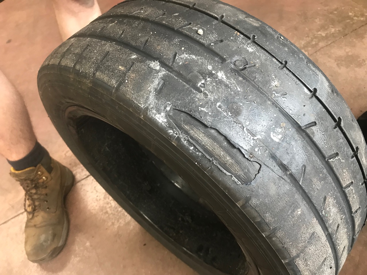

Yeah only ran them 30psi hot as that's what I've always ran my semi's and slicks. I'll up them to 35psi like you say, and see how I get on. Camber is -3 all round so not to aggressive.

Apologise for giving the wrong info yesterday I said 35psi when it was actually 32 psi.
This is from Yokohama themselves.
"If suspension is adjustable front and rear, then no need to run higher pressure in rear tyres , Maybe try a bit more in the front – 32 psi [2.2 bar] hot, bit less in the rear hot 32 psi same as front."
I would usually run 30psi hot in the fronts and 35psi rear when using A50's.
"When checking tyre tread temperatures hottest should be on the inside, and total difference of inside, middle, outside should be around 15 -20 degrees C. if inside shoulder is too hot it will just wear out quicker – same as you have seen before with the outside [rolling over]."
