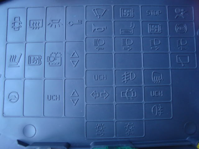

This is out the 182 manual:
Re: Fitted a stereo - heard a pop, now Clock doesnt illuminate and CC does but no dig
thanks :)
Is there one for the fuesbox in the engine in the manual - i get the feeling thats where my problem smay stem from :S?

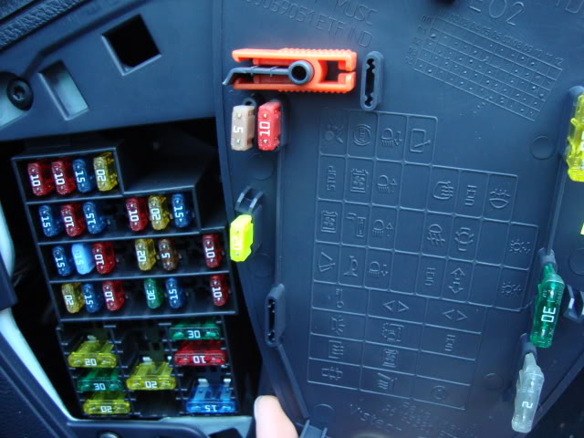

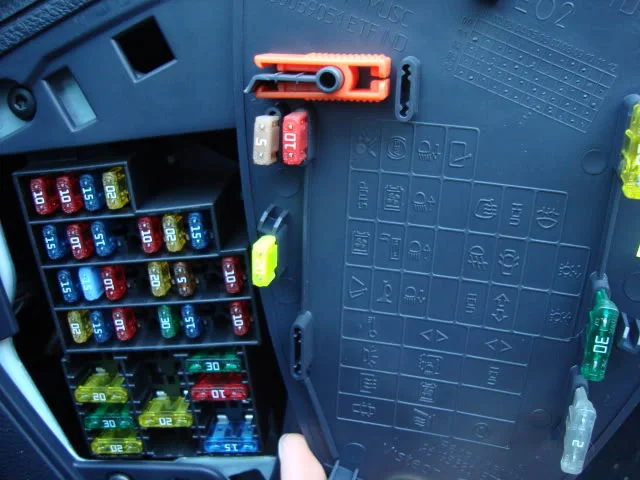

..is looking like i've blown my centre console fuse (somehow) whereever that may be..
Does anyone have a fusebox diagram for the engine bay?
My Interior lights are also dead - its as if everything down the middle of the car has been blown - any ideas where the fuse for this circuit might be?
Its as if everything that relies on getting a live off the ignition has blown (wipers, windows and exterior lights all work fine)

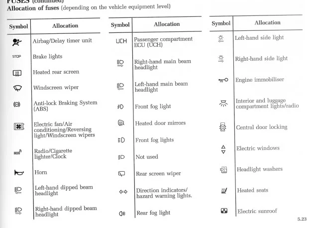

Interior and Luggage Compartment lights/radio 20w fuse had blown.
weirdly i don't have that symbol on my fusebox diagram :S
Anyway, all fixed - Thanks for the diagrams and help
