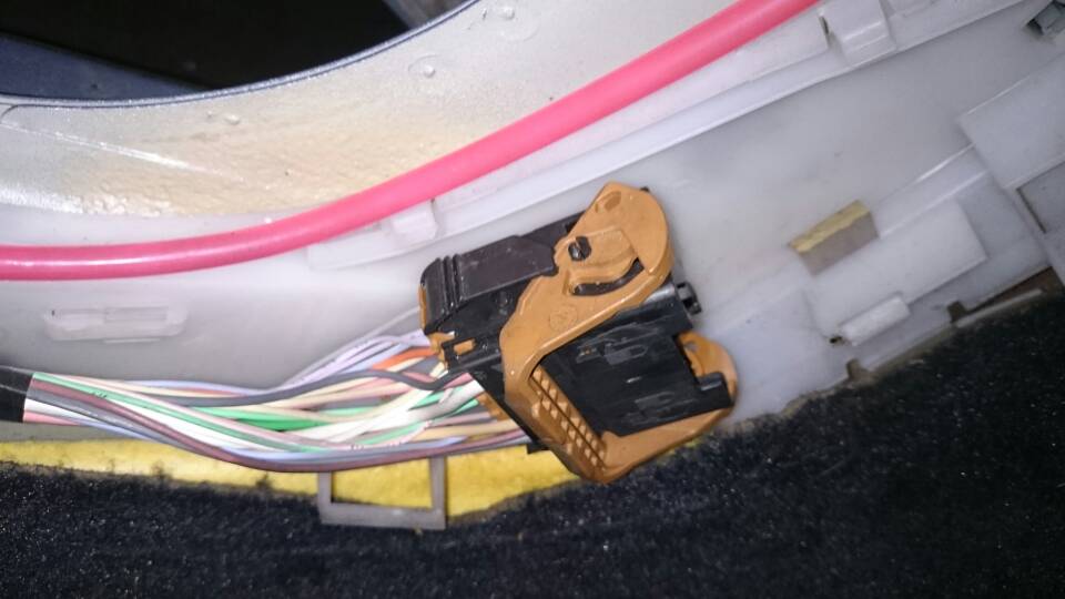

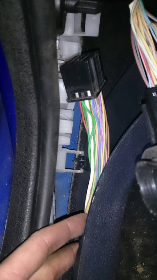

Just to let someone who might want to try this, my cup and non-cup interior looms have different plugs! I couldn't be arsed to check the rest but a major one that is on the passenger side of the car and goes to the rear is different. I assume this is for all the rear lights.
Non-cup 2003 03
Cup 2002 52
