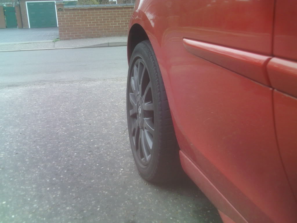

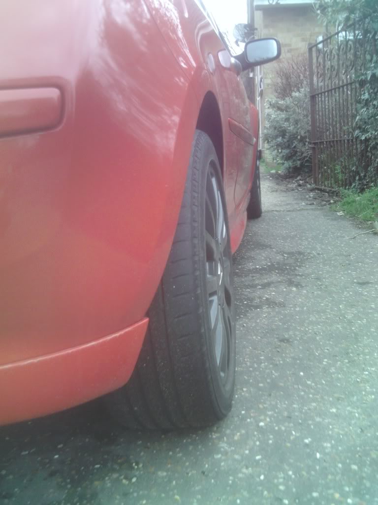

Fitted my back spacers yesterday 25mm, happy with the result but will look even better once lowered more. be fitting the front soon once my new HID's come:)
Mods to come are remap, filter HID's custom exhaust
  Slow red one
Well it's lowered by 30mm which was an improvement but as you say need to be lower with spacers. Got delta mic spacers in the end as another member on here used em.
