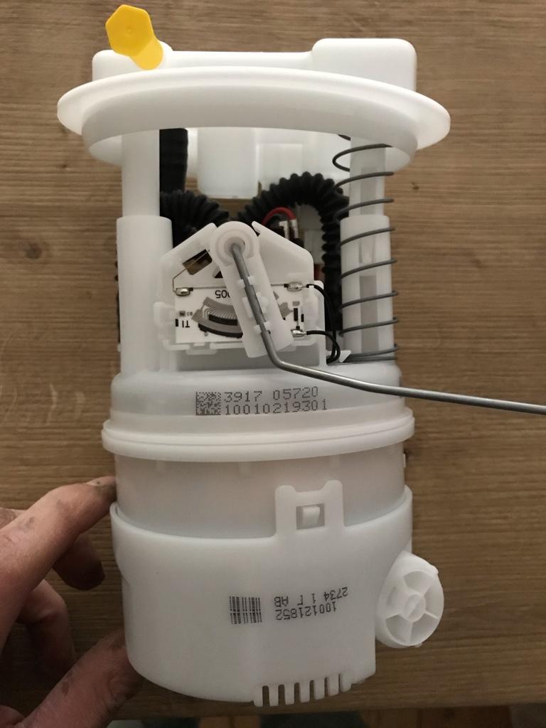

I’m planning on fitting a replacement fuel pump assembly on Wednesday. Is there anything I need to know before I get stuck in. I was thinking about filling/priming the fuel pump? Any issues with air locks etc? Or not necessary.
The reason for fitting a new one is hopefully to stop my lazy starting issue. Car usually only starts once the key has been turned once (not all the way) then again. The issue is more common on “hot” days.

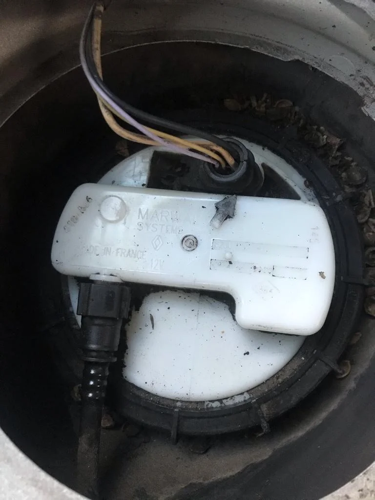

Here is my existing pump(single output type).
(Going to have a proper clean of the area before I attempt to open it up)

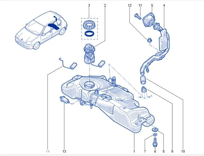

Part number is 8200 057 324
Drawing from parts catalogue.

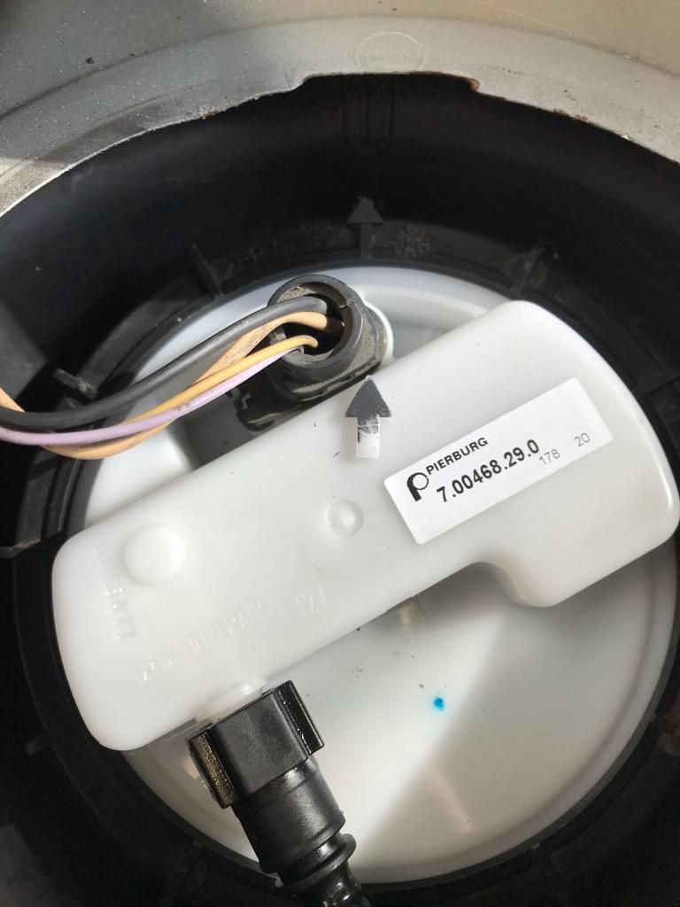

Swapped it today without an issue.
I used a thin piece of wood instead of a screw driver with a few knocks of a hammer to get the plastic ring moving. Didn’t put up too much of a fight. [emoji120]
New pump.
New pump in place. All the arrows lining up. Happy days.
Seems to be working fine so far. Will need a hot day to see if it cures the “lazy” start issue.
