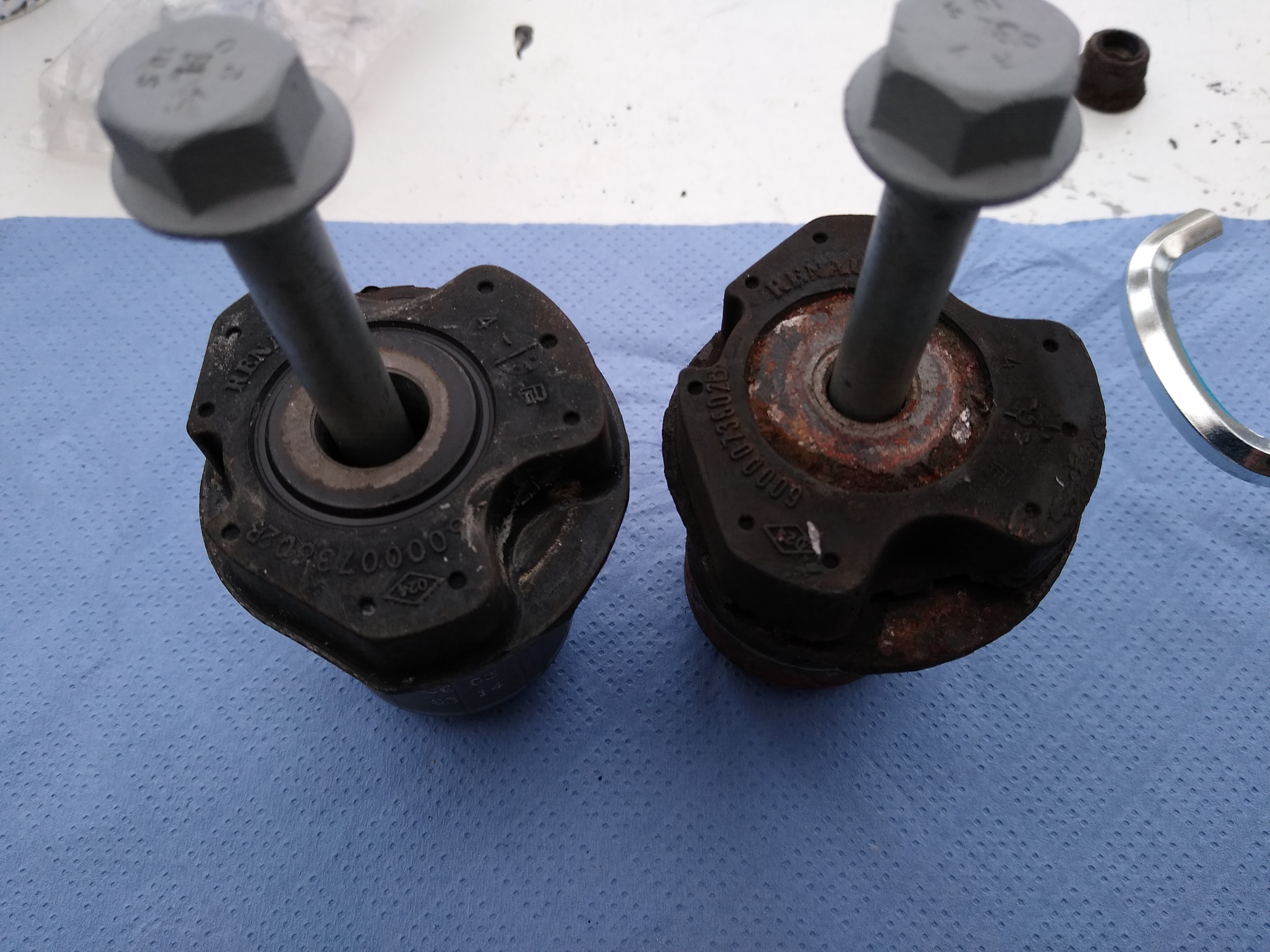

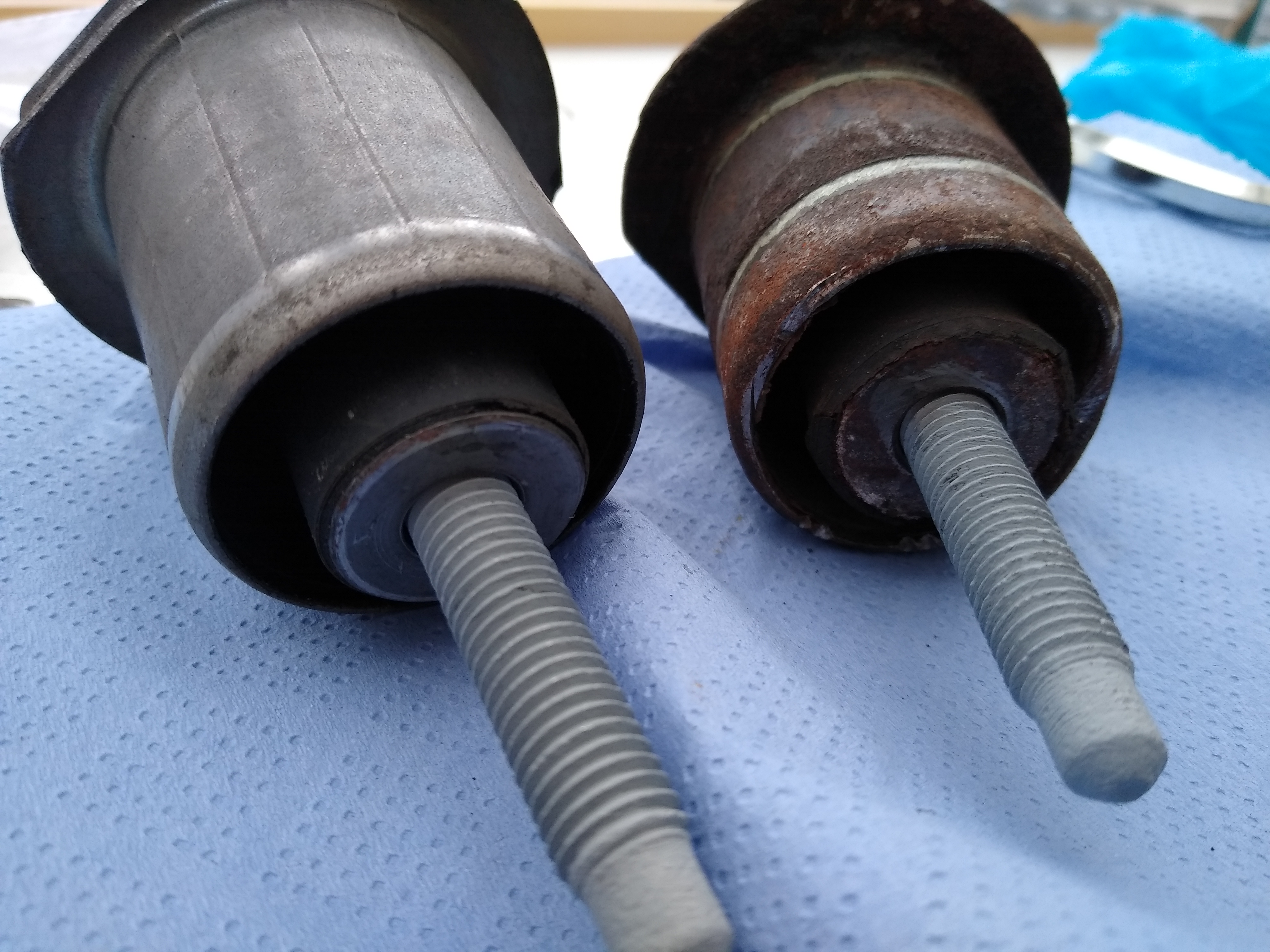

I'm doing a rear beam refurb and have new renault bushes to fit.
The new ones have a different bolt hole diameter to the originals, or rather for part way through.
Hopefully the photos will explain what I mean with the new bush on the left.
Do these new bushes just fit straight in does anyone know?

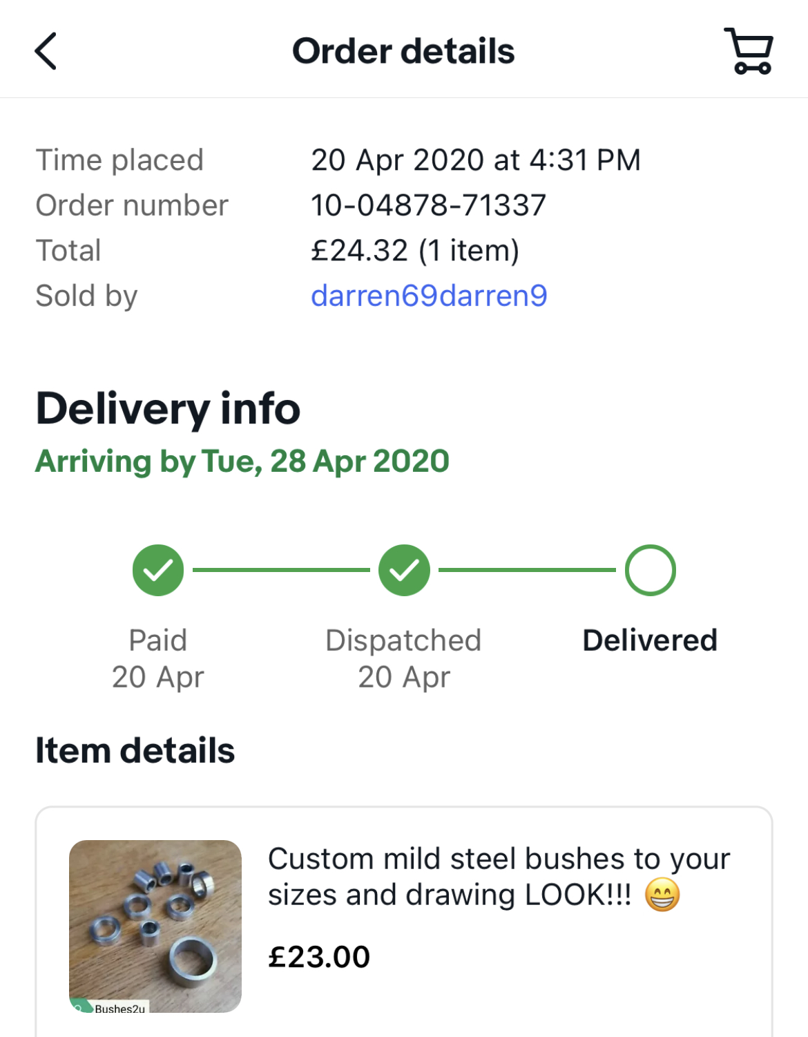

The OE bushes are a real pain in the RS... if I did it again, I’d be fitting polybush jobbies.
But what you need to do mate, is get in touch with a chap on eBay called darren69darren9 and ask him to manufacture a pair of bushes like he made for me in April 2020..
he should be able to track the drawing down from this photo:

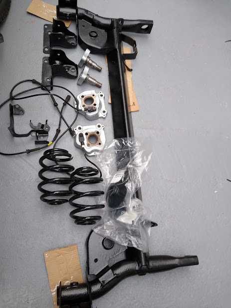

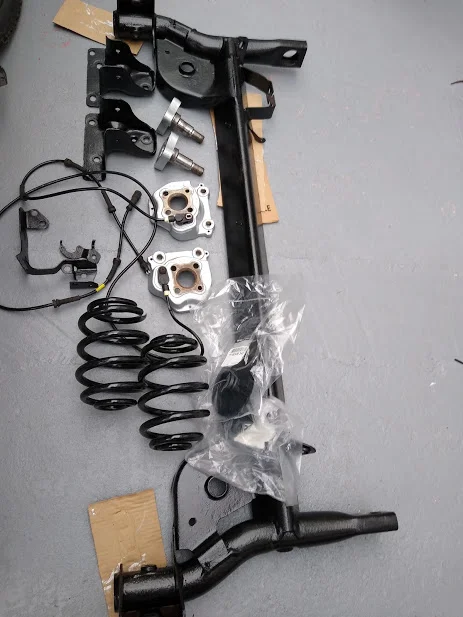

I derusted and painted up my rear beam. I'm very pleased with it but it did take an age and I think your powder coated does look better. So next time it will be powder coating and poly bushes!

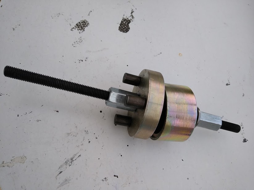

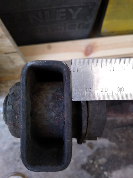

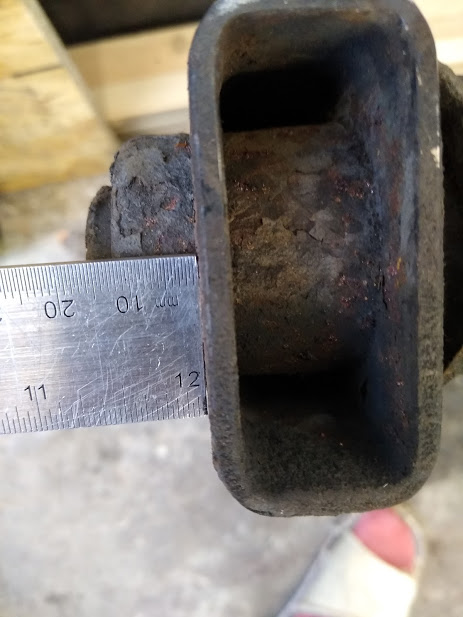

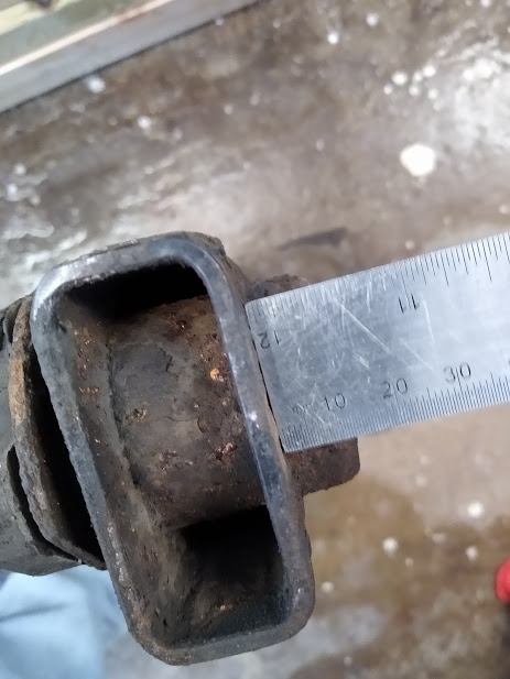

Yes I did measure them plus got old ones which shows unrusted band where they sat in beam. And I bought some device off ebay for pressing them back in....
