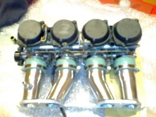

is it possible and what would be needed to fit yamaha r1 throttle bodies on a f7p/f7r engine.
Surely i would need more than that. And wat price am i lookin for somethin custom like that.
Carbs would be easier, ive done it on my 205
You need;
Manifold £150
Fuel Regulator £50
New pump £50
Carbs £100
Filter/s £30
And some wireing and switches £20ish.
What carbs? lol.
Bodies, you will need something like a megasquirt or similar.
as above really.
would be better off with a set of twin 45 carbs. if you on a budget.
manifold can be had from chadil, can be bought for either megane or willy/valver head, think they about £250, but you will spend time on it to match it up as they are a poor quality really.
