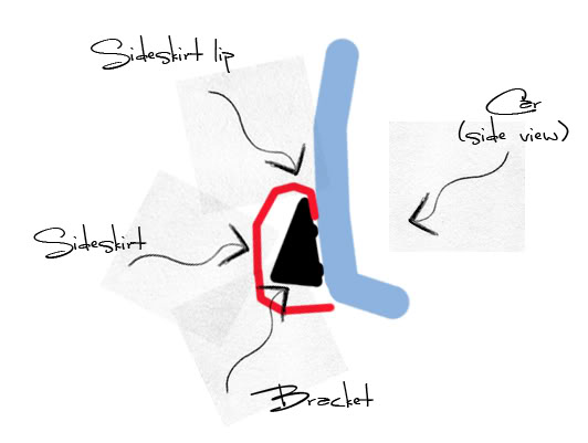

i bought some side skirts to add the final piece into my rep, just a quick question of how they actually fit on ? is it just bolts onto the metal strip underneath the side of the car ? and then a rivet either side on the ends ?
nope mate, you need to get some side skirt clips which are rivetted along the lenght of the car the skirt has a lip on it which slots between the car and the clip
