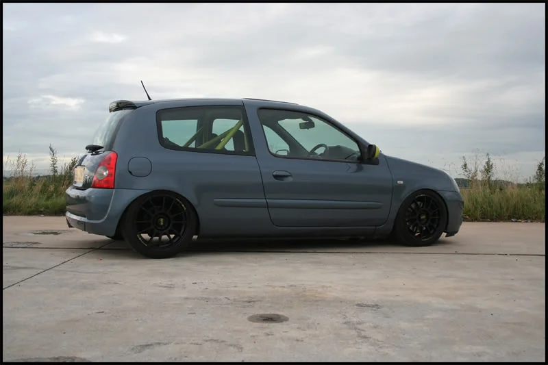

mine on 60mm drop with stock 15s:
The sport side skirts do not fit the non-sport wings so they wont fit. You can get replica ones from K-tec IIRC that look like the sport ones and will fit onto non-sports. They fit onto the sills underneath the car, a clip drilled through the sills, then the sideskirt clips on. As for a drop 60mm will be fine, scrub abit will look good. I had 40mm on mine with 16" alloys and the back sat just above the tyre but front wasnt low enough. I have some 40mm springs for a non-sport for sale. ;)
