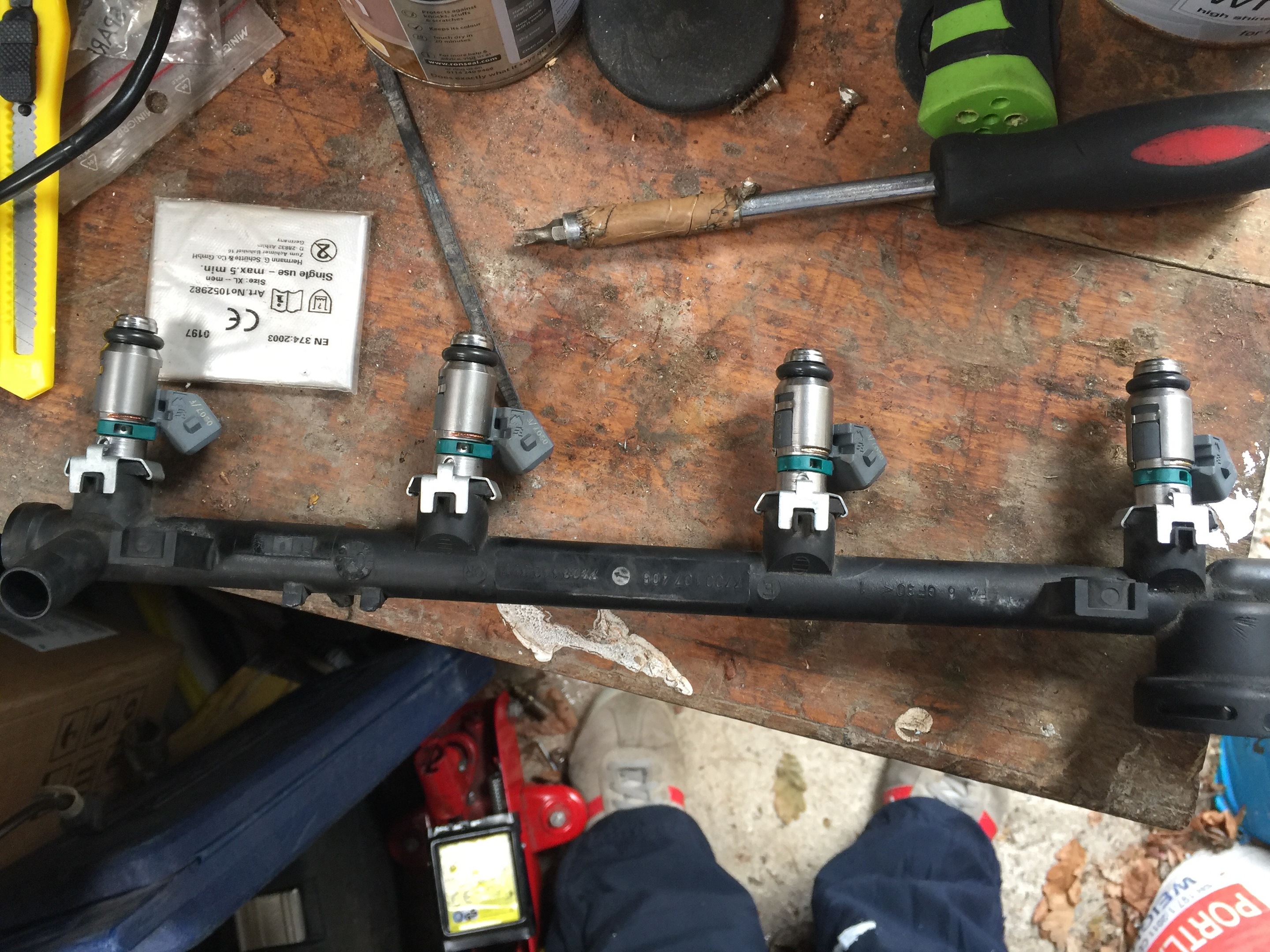

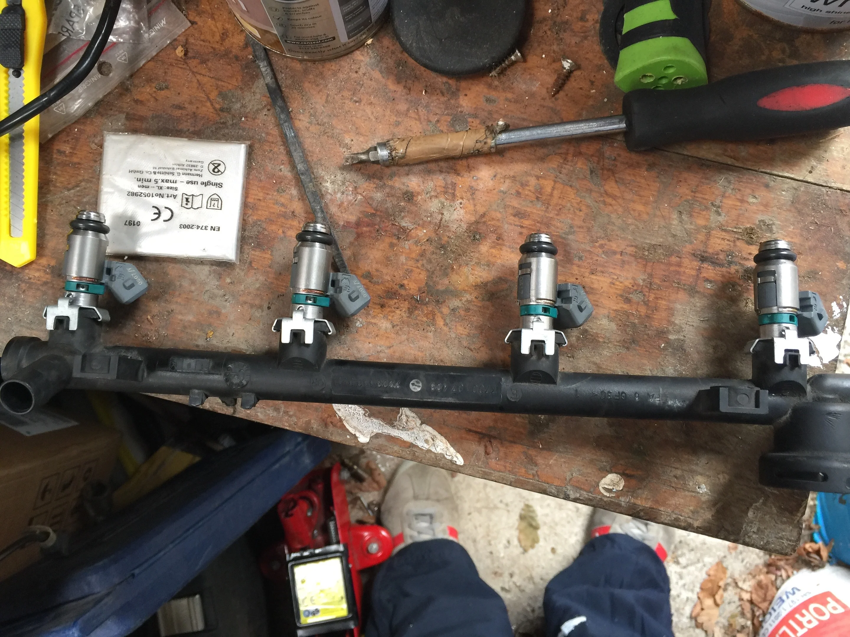

Injectors arrived yesterday, I just swapped the three remaining out ones out for the new ones. No more lumpy idle or flashing EML light.
