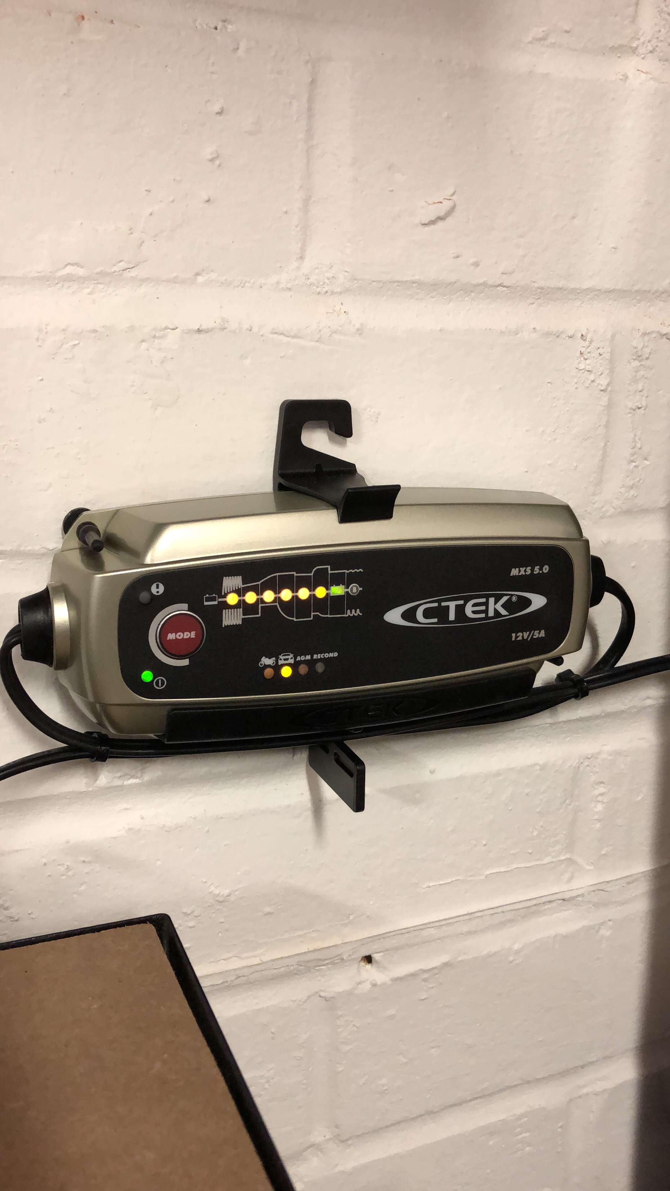

CTEK MXS 5.0 and buy the comfort connect so you can literally lift the bonnet and plug it into the mains.
Can’t believe I didn’t buy one years ago!

I agree but I was having the same issue with my car (it is a track car so doesn’t get daily use) but I have the same battery as you and even had that replaced by ECP thinking that I had a dud. I had a new starter motor, new alternator. New Earth strap, everthing checked and it would t start after the same period of time being stood.
Ever since getting the CTEK it’s started every time with no issue.

The Ctek extension lead has been fine out in the rain, mine's outside and permanently plugged in.
