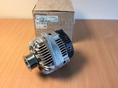

I went with a new one from Renault Wolverhampton on eBay and it's been fine for over 2 years.

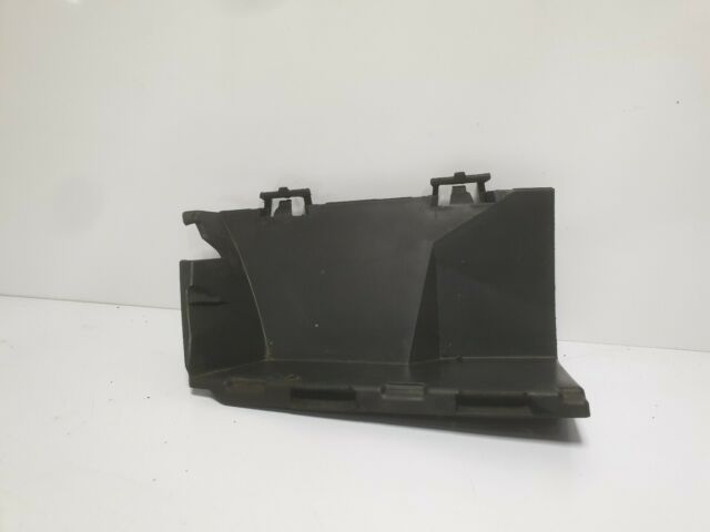

Have you got the plastic guard behind the front grille? It protects the alternator, especially from water.
Yeah I'm sure I do have the guard, Are Wolverhampton the cheapest for a genuine?

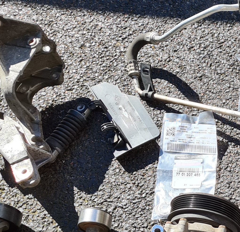

Which plastic guard is that? I've just moved my alternator and can't remember having a guard?

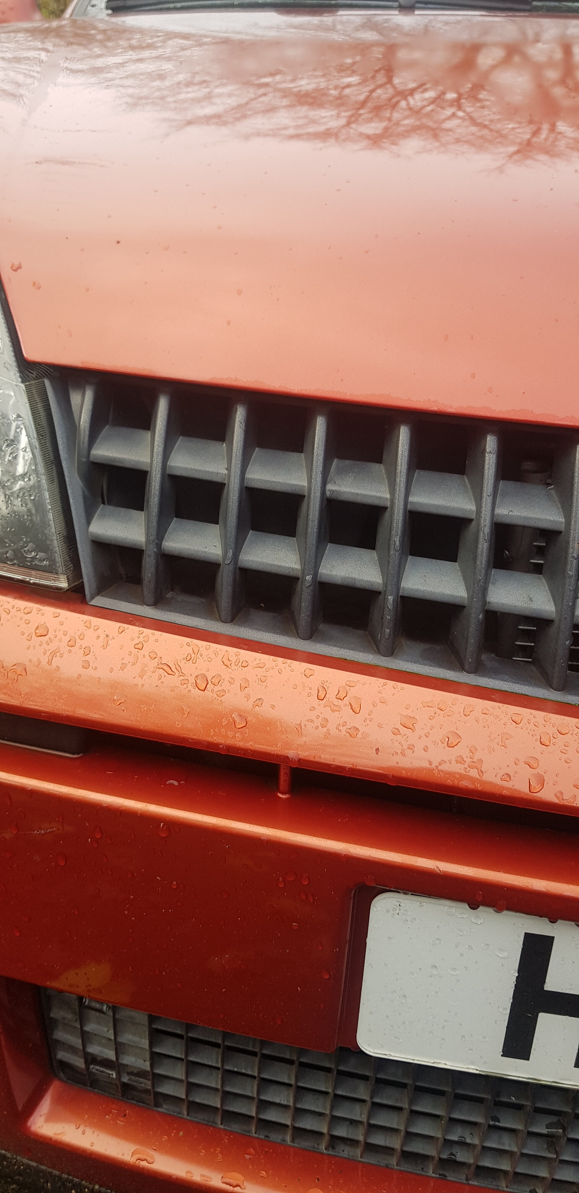

That's the plastic cover behind the grille.
You cant really see it but the point is you cant see the alternator, which you would without the plastic cover.

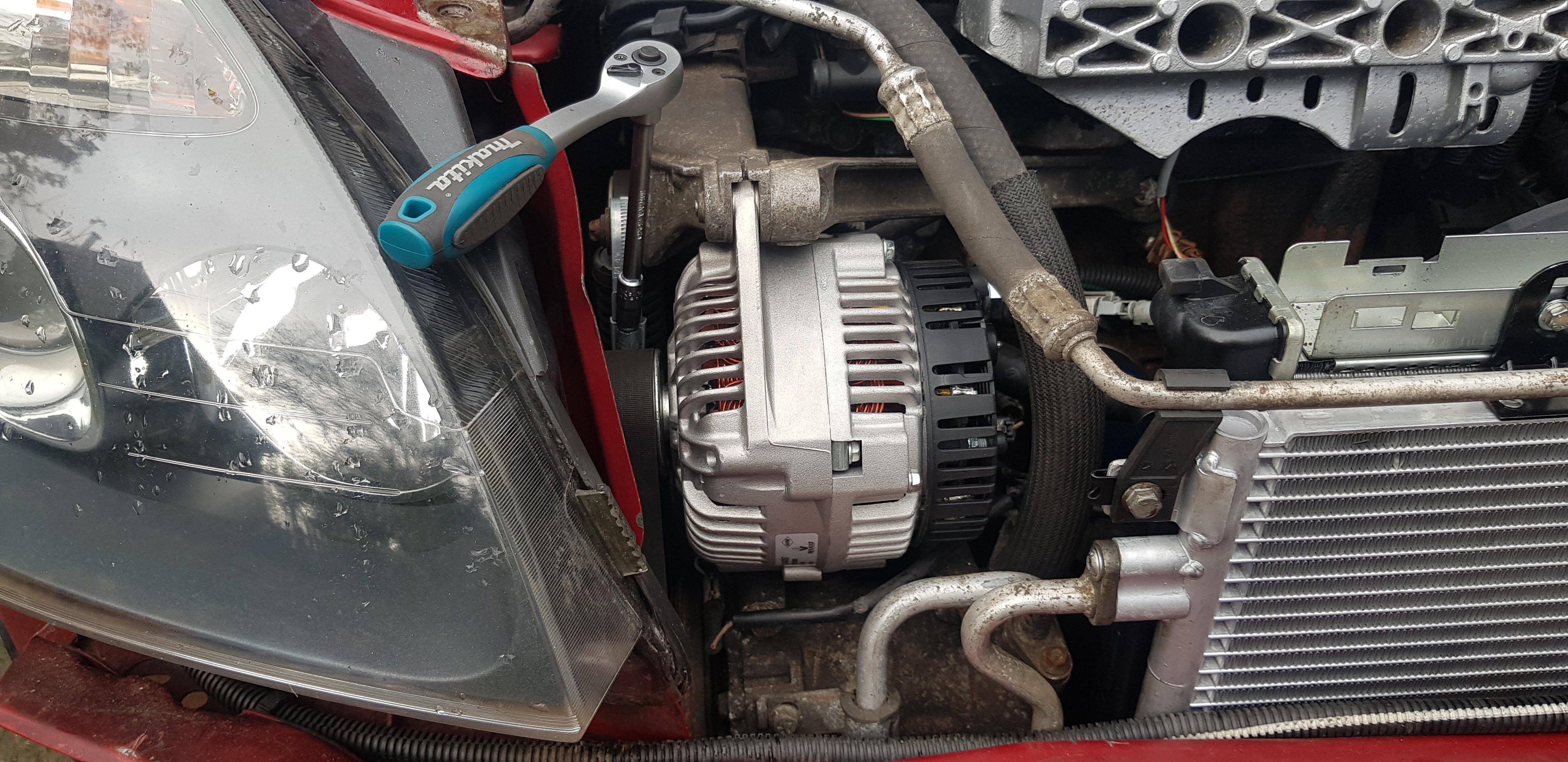

Before fitting your new alternator, check for oxidation at this terminal.
It is a common problem, and will cause the alternator to cook itself.
