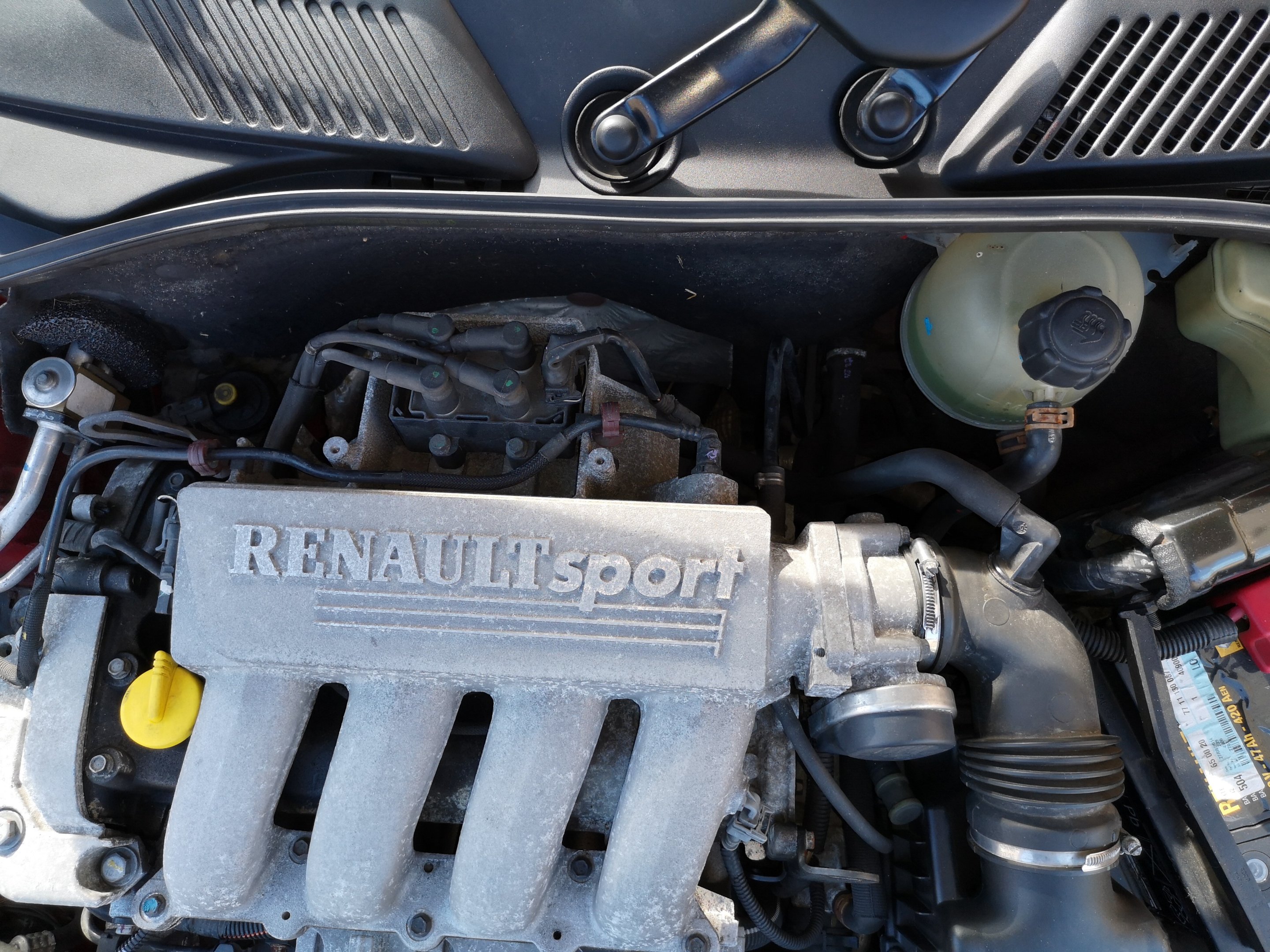

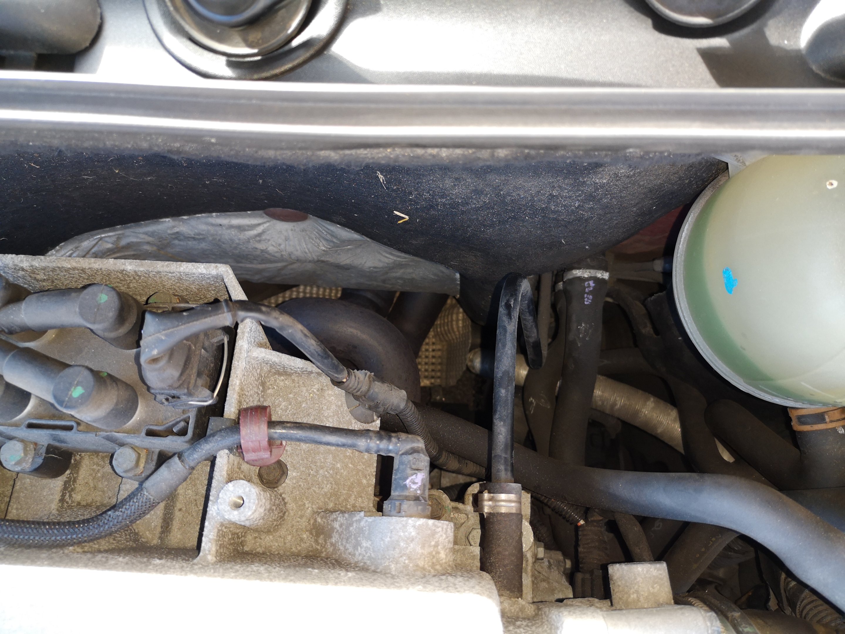

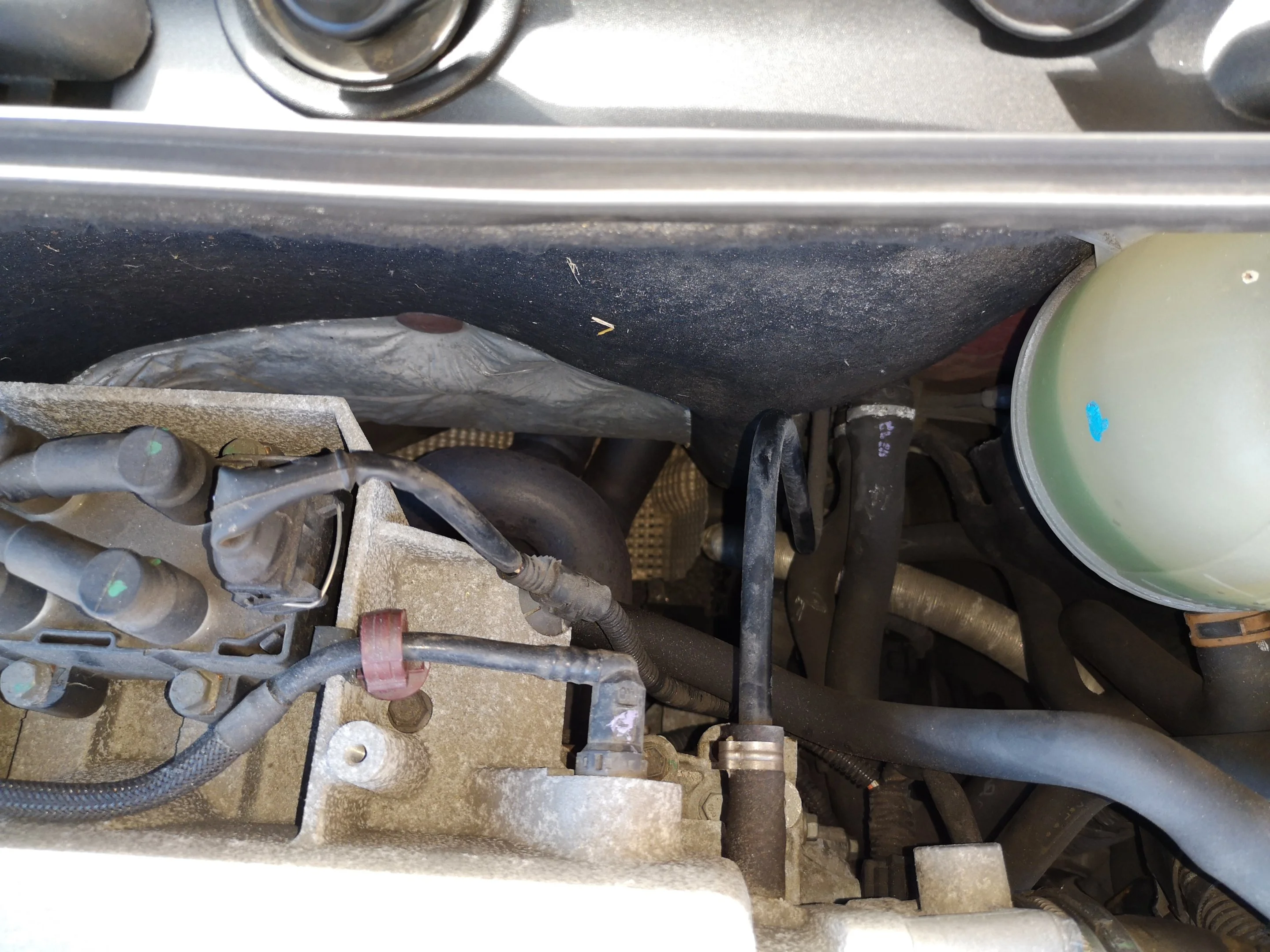

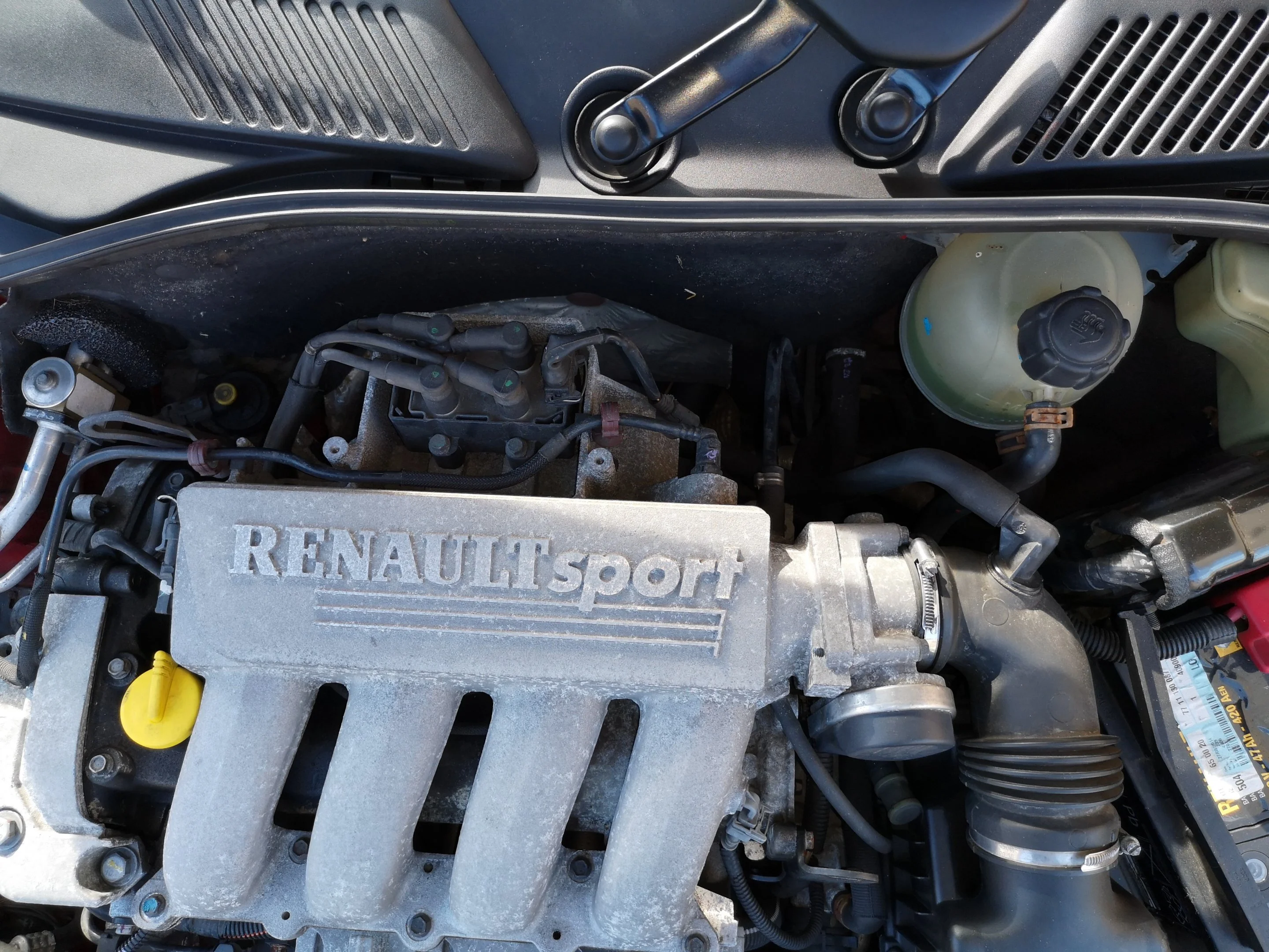

Ok, removed the scuttle panel. Snapped the passenger wiper trying to get it off, then had to hacksaw and drill the rest of it off.
Why does this need to be removed again? Just to check it's clear?
There was a small amount of leaves in the passenger side, but not enough to be blocking it.
I pulled out the arch liners, both the holes above the liners were clear each side.
There was a ton of dirt behind the foam insert in both inner wings. Dug all that out.
Where is the location of this fabled middle drain? I can't see a hole sticking out of the bulk head, do I need to look from underneath?
