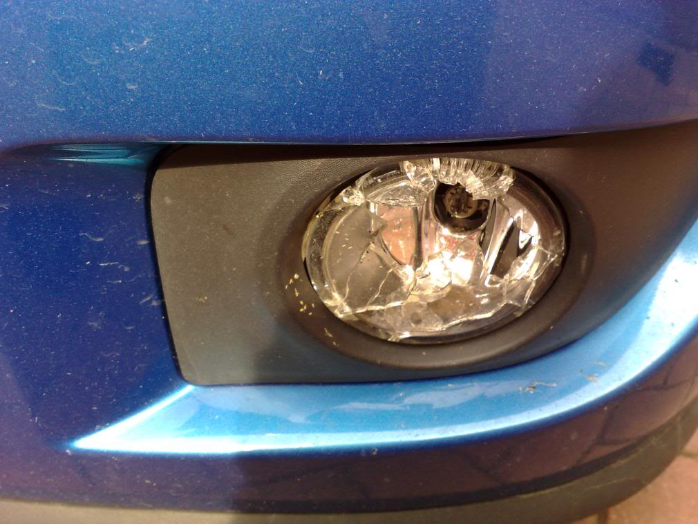

ok a stone smashed my front fog light on my 182. just been to renault and they told me its £72 for a new one!!!! £72 fook off
its comes as a whole unit but i only need the lens. anyone help?

I purchased one for around £40 a couple of years back from Cliospares. They've changed their name recently but I'm sure someone will know what they're called now.

get yourself on ebay mate, i just bought one for about 20 quid two weeks ago. if it is just the glass bit your sorted. dead easy fix too. :D

managed to get mine as a buy it now like mate. just don't buy from wing mirror woman, dodgy cow, sent me the wrong side and then didn't answer emails. got refund from ebay in the end but a total pain in the arse.

They're all the same mate, you don't need a 1*2 specific fog so long as it's a mk2 ph2 one.
I got mine for about £25 on fleabay!
As for removal you need to get under the front of the car. Remove the splash guards so you can see up behind the fog. There are three (I think) torx screws securing the unit to the bracket, undo these, unplug the wiring and you're done. :)

awesome cheers
