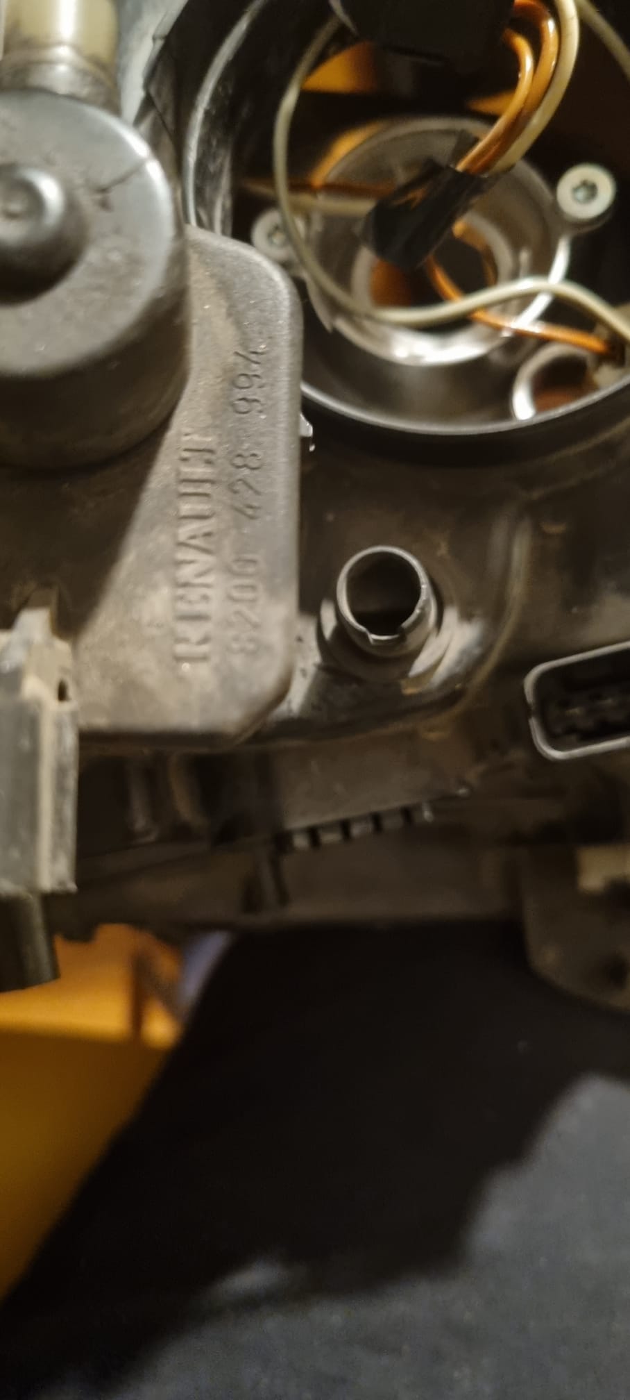

Btw, I checked the vent hole with the small curved tube attached to be free of any debris and it was fine on both headlights.

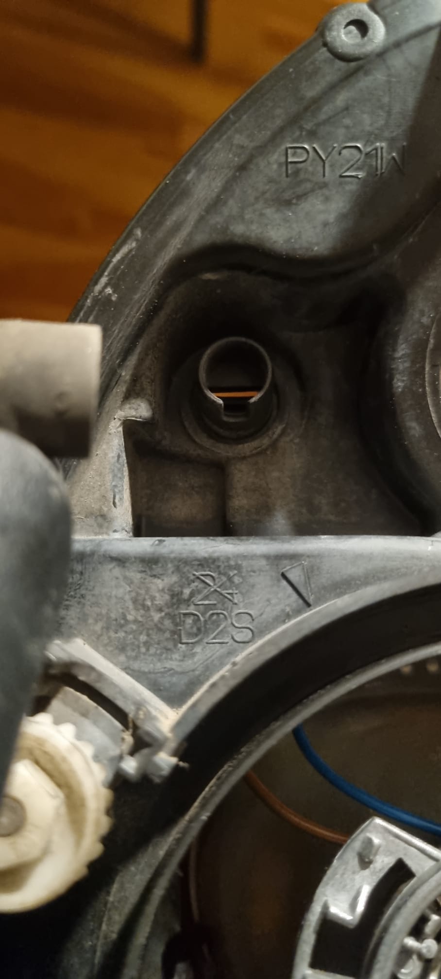

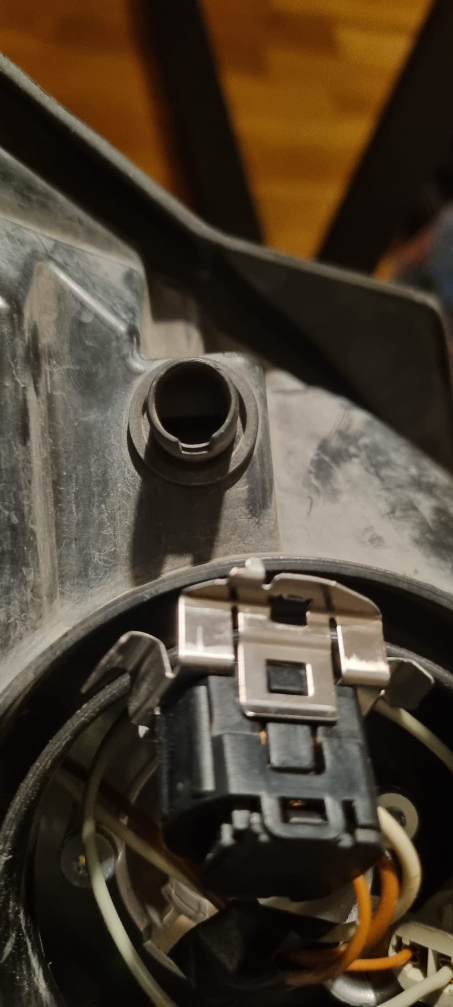

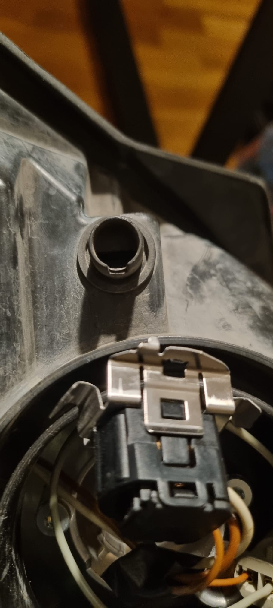

On that matter I noticed that there are actually three mountings for that C-rubber that attaches to the vent tube, but only the one where the hose it's attached actually has a slit in it to breathe (see the pics), while the other two are plugged. Why are they there to begin with if they have no purpose?
