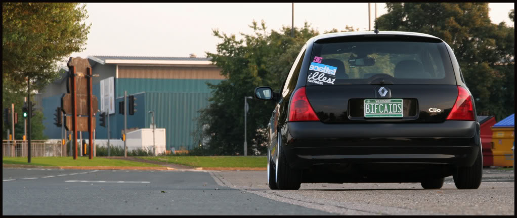

im running 25mm on the back and im running 20mm on the front all hubcentric.
best pic for the idea bud im also running negative camber on the rear for added clearance aswell as stretched tyres.

Standard dynamique 15's with t1-r's, Have you any pictures james?

mine are deltamics just so you know! think of how hard the setup is and the camber on the rear.
