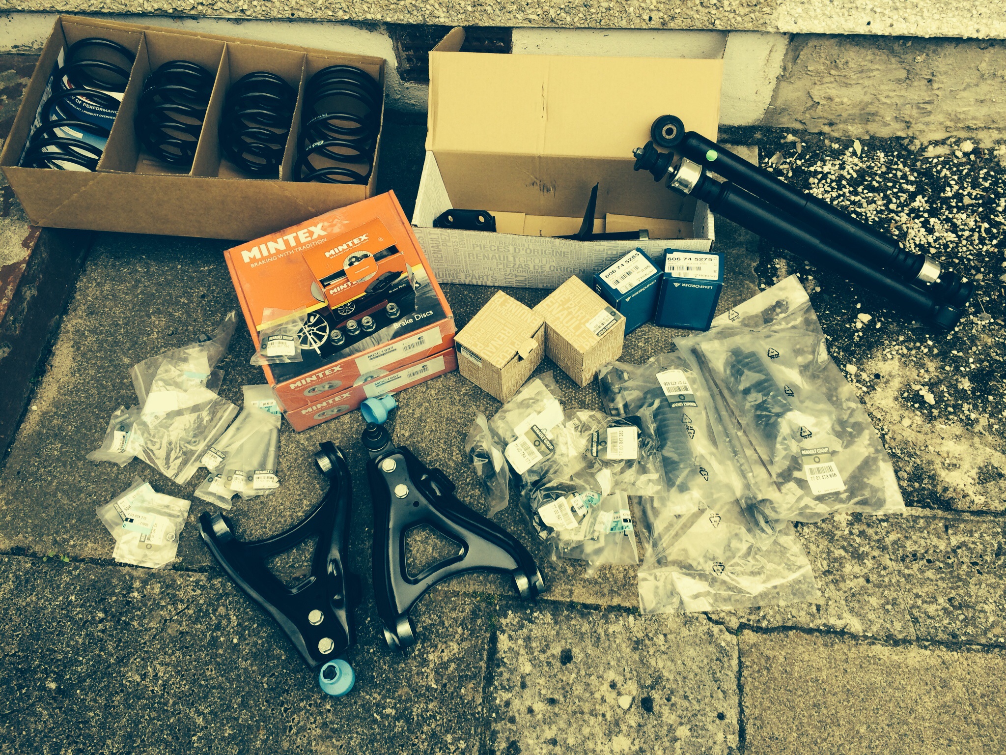

For anyone who maybe planning the same, I've just ordered.
Front shocks x2, rear shocks x2, strut top mounts & spacers x2, tie rods x2 ,wishbones x2, (Renault Wolverhampton) £396
Track rod ends x2 (Carparts4less) £29.76
Eibach Pro springs x4 (KamRacing) £171.70
I've also ordered the following for the rear.... I'll be refreshing the rear axel once the front is complete.
Mintex Rear discs, bearings and pads (Ebay) £59.90

I've come across hundreds of open-ended threads on here, so a quick update to finish this off…..
We fitted everything last week, everything bar the inner anti-roll bar bushes. I also went for 4 new tyres.
What a transformation!! Previously, nothing specific was broken or worn to the point where it (exclusively) hampered the handling, but a combination of everything being 12years old and a bit tired made the drive a little frisky.
Now it feels smooth, turns in quicker, more balanced at speed, no wobbles etc etc. The only downside is that it feels slow now because it's so controllable.
I bought this clio a month ago as a super-cheap run-about, but after changing all the suspension components, brakes, bearings, tyres, de-phaser and all the belts, it now owes me £2600…
The power steering pump has just started whining. There's also a few minor dents and scratches to be sorted so I'll no doubt be pushing £3k by the time it's all done.
