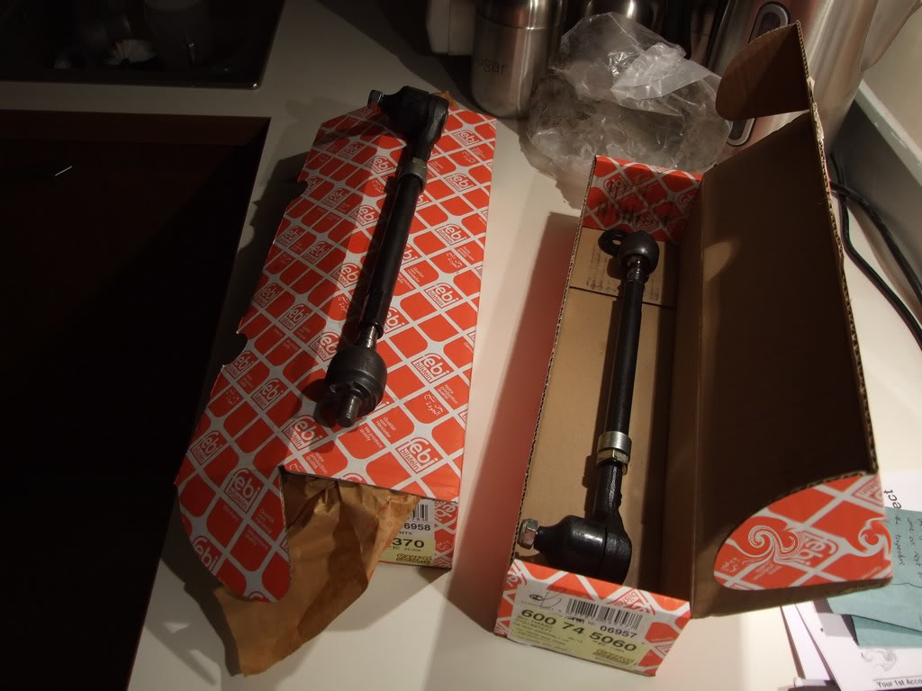

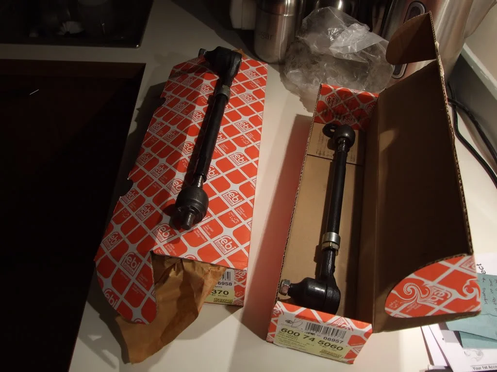

Between the rack and the wheel you have two parts - the Tie Rod end and the Track rod end. (They're called a number of things but you get the gyst lol)
The Tie Rod end is the rack end of the rod (the fat bits in the pic), the Track Rod end is the wheel end of the rod (with the bolt on).
Have a look at EuroCarParts website for suspension components and see what the 172 ones come up as. Complete arms, Tie rod and Track rod together, cost me just under £90 for a valver so I imagine yours will be similar.
*edit* D'oh, I just reread the above and checked for myself and you're right, they don't come up at ECP!
Fitting is a b**ch though... I'm not looking forward to it lol
