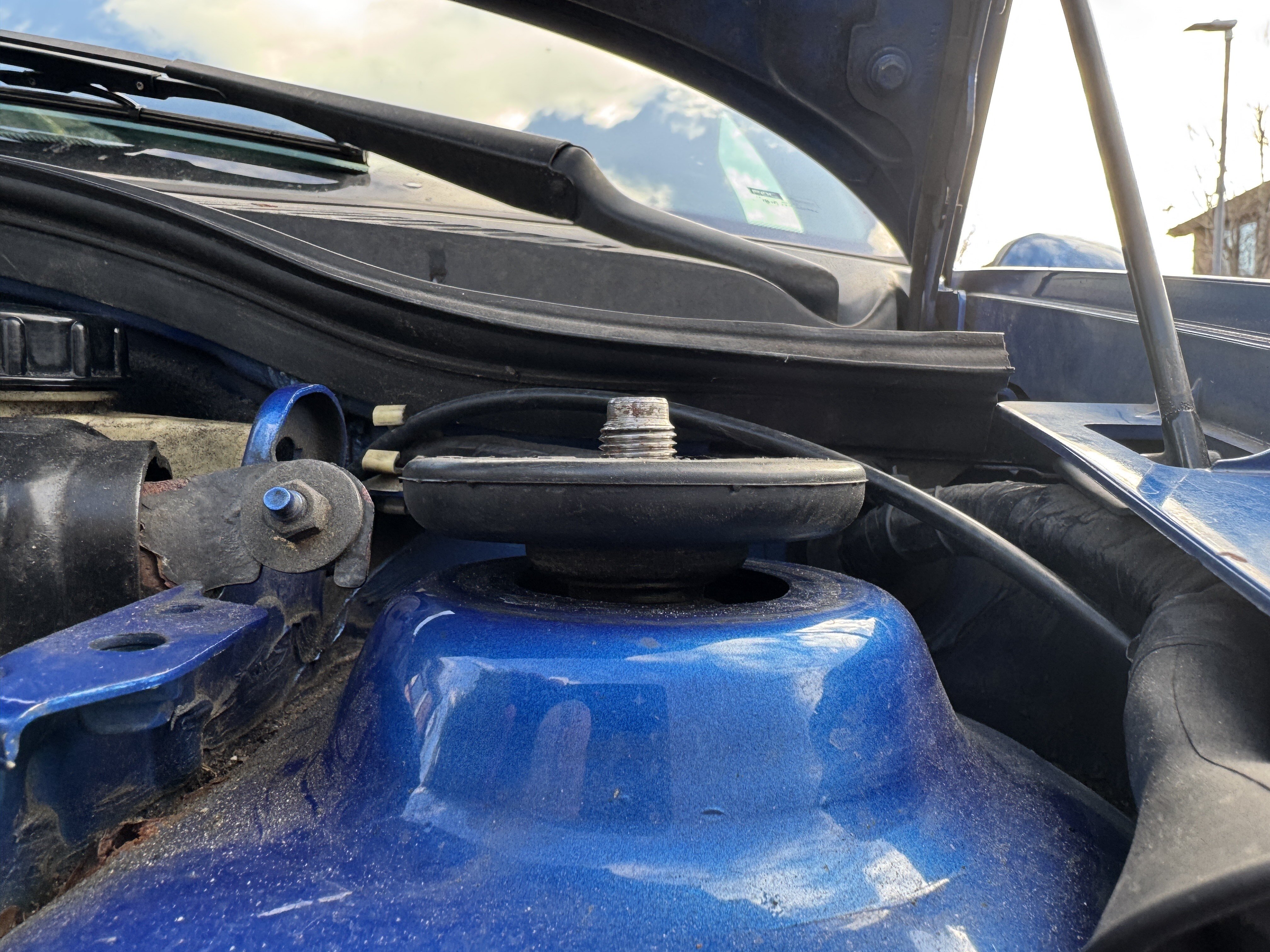

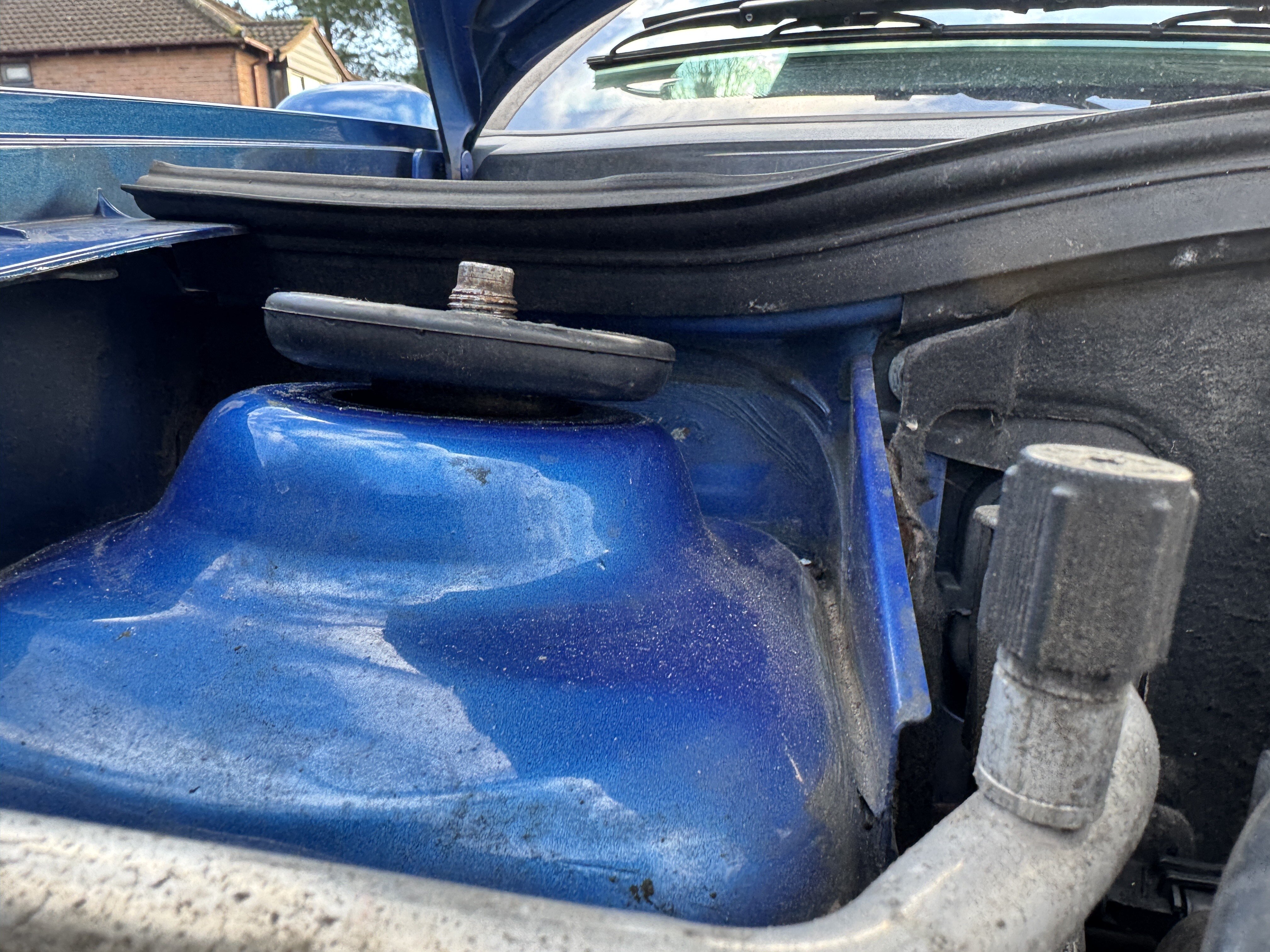

I still have play in the top mounts, even though I had OE replacements fitted in the summer. I have noticed that the passenger side top mount (the side with the play) sits about 1 cm prouder than the driver's side. This is despite the same number of threads showing. What could cause this? A poorly seated cup?

Are you sure all the bits of the top mounts are there and in the right order?

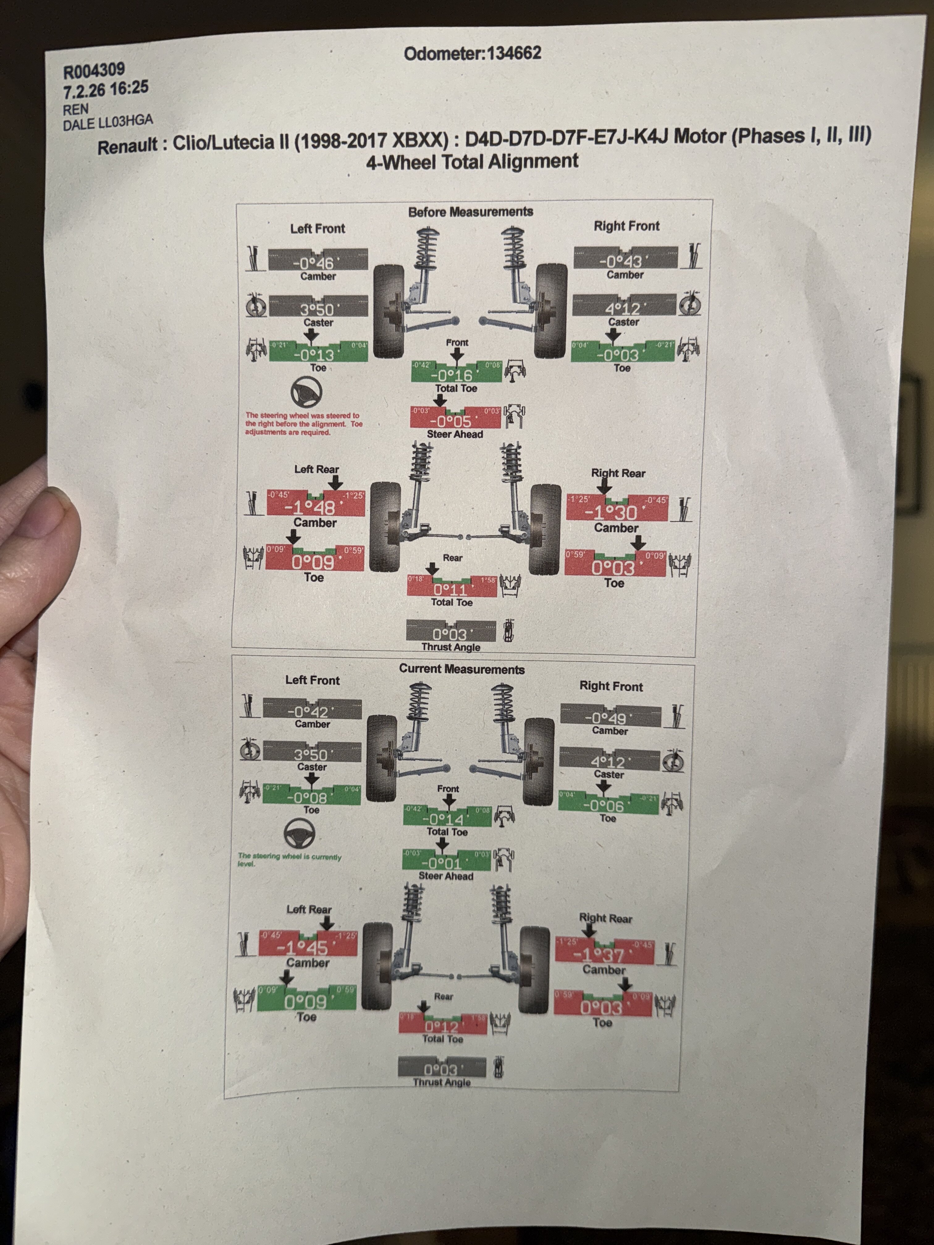

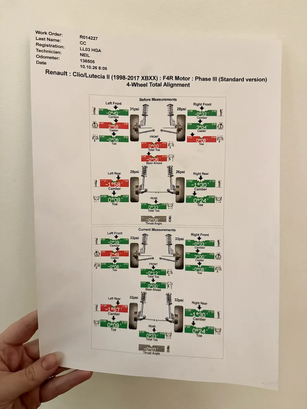

Took the car for alignment today and got these results. The caster looks odd and I assume is what is driving the arc to the left. What could have caused this imbalance?

Caster angle isn't going to be helping much, essentially your passenger front wheel is sitting slightly further back in the arch than your drivers side.
So I'd be checking top mounts and bottoms arms. Standard caster angle is around 3.0degrees.
Alignment doesn't look horrendous, I've seen a lot worse.
