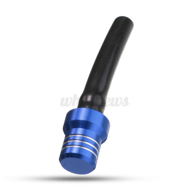

I've got (because I saw it on here) a fuel breather that was meant for motorbikes. One way breather, so only 'out'. Not fitted as I haven't pulled carbon canister yet.
This is what I have. Best fitted with the tank dropped though and not even sure it's doable without removing the tank.

I also have a little one way valve which I haven't fitted yet however I think I will try to install it slightly remotely so I can occasionally check it and replace if needed. Likely to have dog s**t Chinaland orings inside which will degrade over time and remove the one way valviness.
Shouldn't it be only 'in'? Because when the fuel get's lesser, air should replace it?
