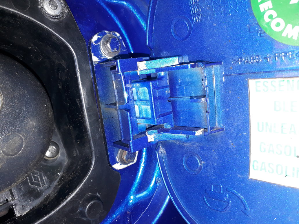

Hi,
Should it be of use to someone, it is possible to repair the mounting bracket if you can collect enough of the parts together. I glued mine back together and then used a junior hacksaw to remove the bolt head plastic surround, so it can be mounted back on using standard nuts and bolts with washers.
Photo attached. I will be painting the bracket and bolts with touch up paint once it's delivered.
Hope this helps.
Thanks,
