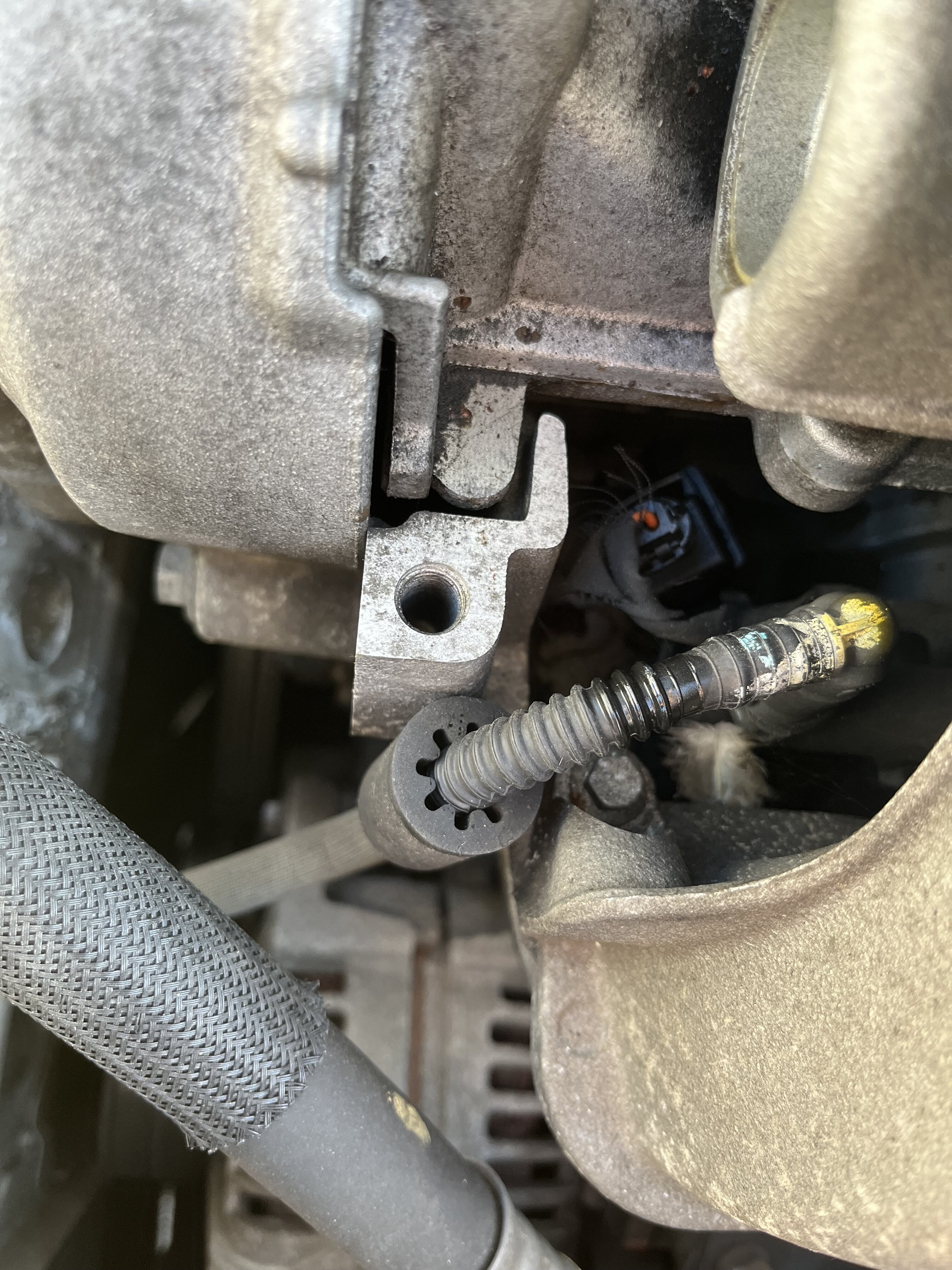

Hi all, I’m a bit stuck. Can’t seem to find a part number for my mk3 for a fuel line. Got a pin prick hole in it doesn’t seem repairable, also any advice on how to change it?
Thanks in advance

Replace the short flexible section with high pressure fuel hose, cut it off the fuel rail connector carefully and same at the other end. Use cohline 2240 R9 spec and proper fuel hose clamps. Dont use cheap fuel hose or you will be doing it again next year.
Ok seems easy enough thanks for the advice, is it an 8mm hose?
