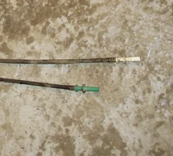

Anyone know which fitting I need to connect a braided fuel line in the engine bay to the underbody fuel lines?
These are the push fit connector ends underbody:
Need an AN6 connector that will connect to the Braided Line and then push fit over those

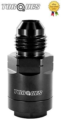

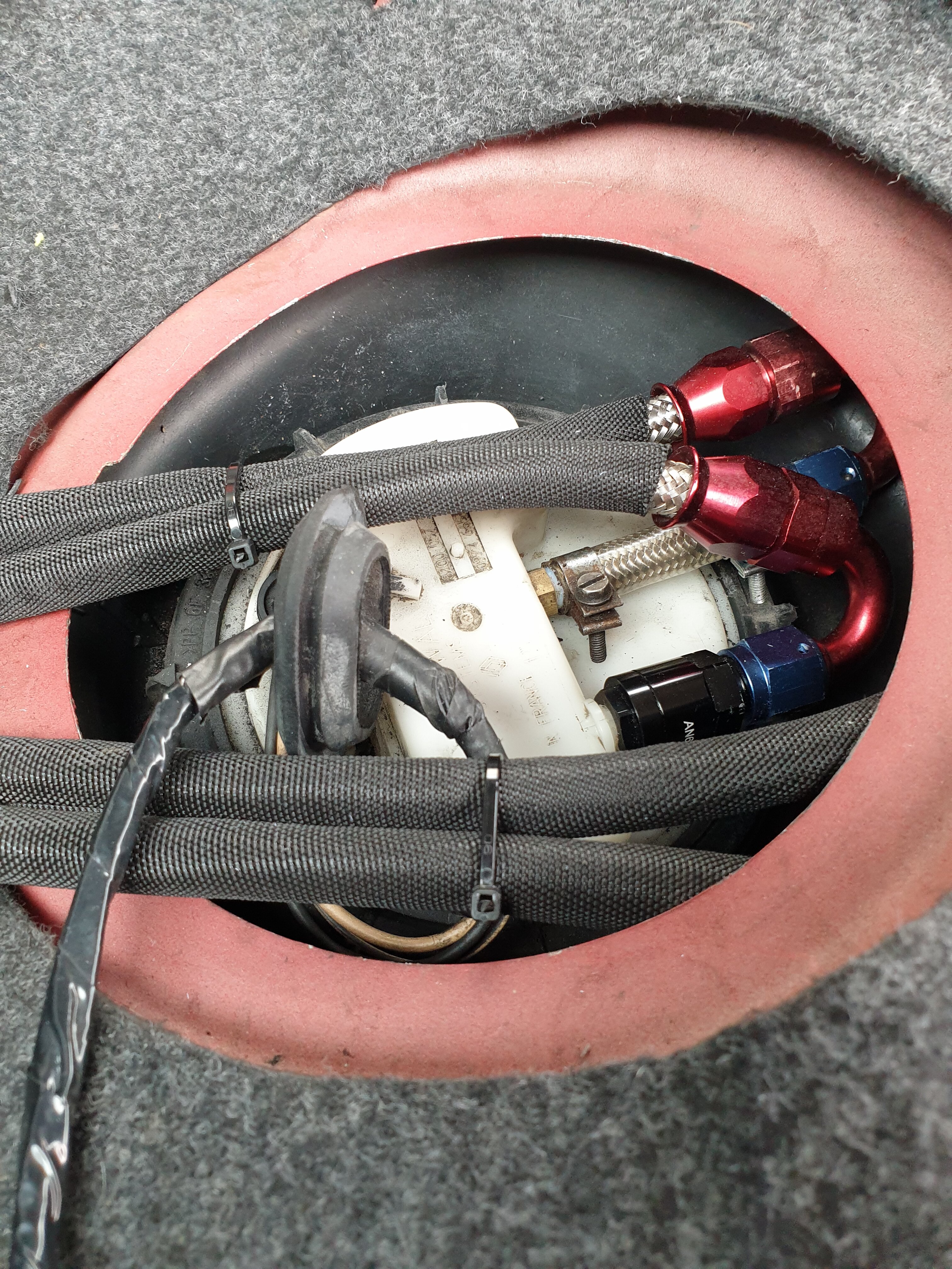

Id personally renew the lot straight back to the tank in an6 pipe and use one of these on the sender. It might fit the connectors on the plastic pipes too but unsure

Torques/motamec an fittings are always pretty decent from experience. Avoid any unbranded chinese shite though.

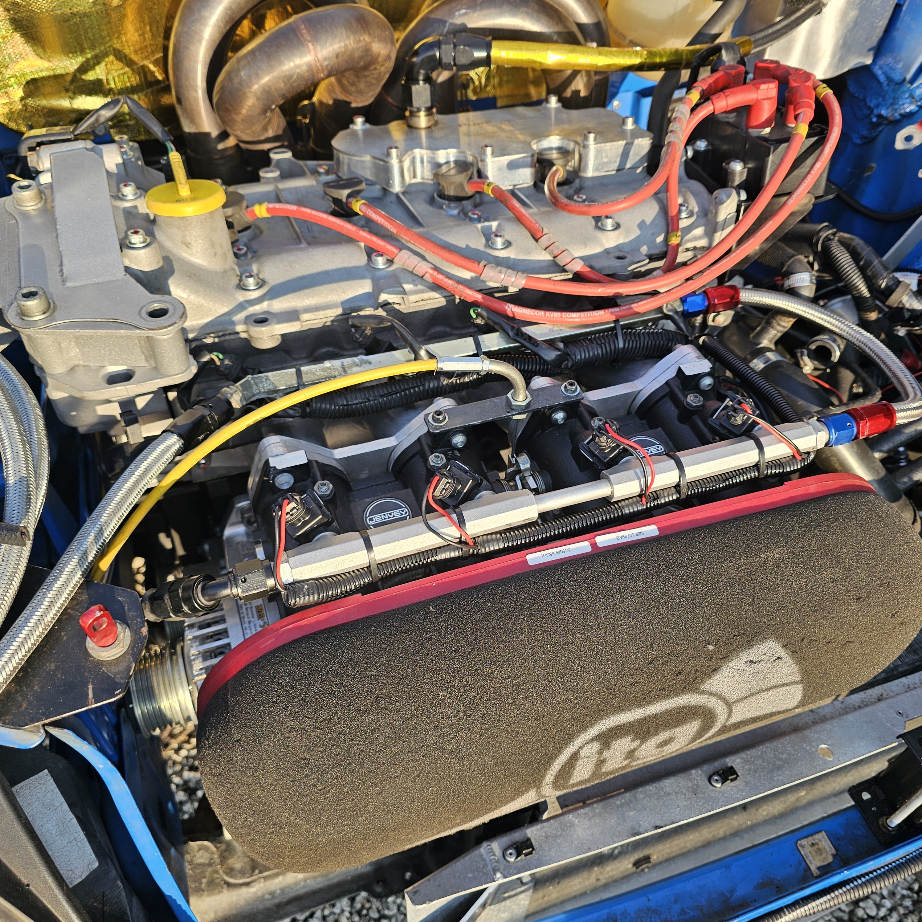

Same with the fuel line itself! I nearly set my RS Turbo on fire because I had bought Chinese braided fuel line, the rubber inside perished with a few months and I had fuel pouring out of everywhere.
